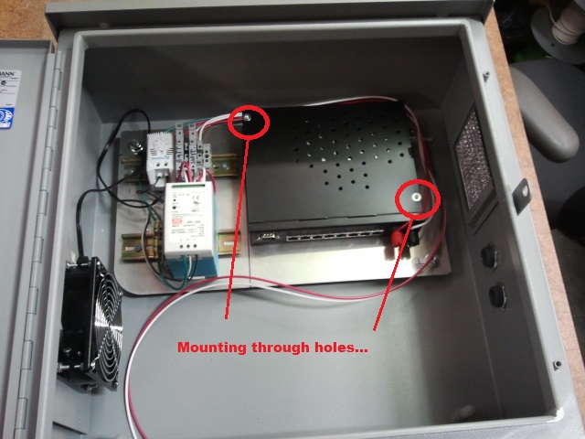

Re: Mounting arms / backets
Something like this?
...that's a Wiegmann enclosure with a typical plate type mount (the empty space at the bottom will be filled with a battery when this is installed in the field).
