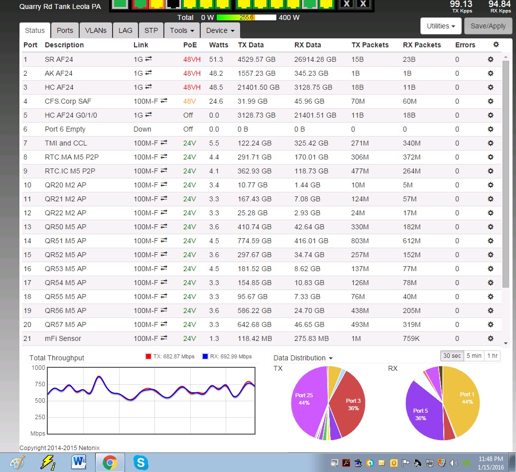

Our switches are rated at line speed (all ports simultaneously) so each switch capacity is 1G x number of ports.
It is late but I took a screen grab just now of one of my towers which you can see is pushing 700+ Mbps or 1.4G aggregate.

We move over 600+ Mb through a 12 port switch in our data center. it doesn't even sweat.
I wouldn't worry about it at all.

gilljr wrote:I have a site that pushes over 700mbps with several VLANs where I am having issues
Please be aware that 1 Gbps port with several VLANs are only able to push 1 Gbps. Just because you throw several VLANs at a port it can't do more than the physical speed.
I have seen people using a lot of VLANs and getting bad performance because they push several hundred Mbps on each VLAN through one port.
It's a common mistake. Of course I don't know if that's what you're experiencing.....
