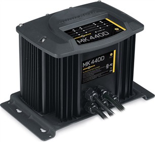

I suggest using MINKOTA Chargers for on grid sites where AC is available.
They are 3 stage smart chargers so they can recover fully discharged AGM batteries if you use the WS-12-250-DC switch to fully discharge the site in an emergencies.
With most batteries if you discharge them below a certain point you need a charge that can charge 10A per battery to recover them.
Not sure why you are using these, the whole idea of our WS-12-250-DC switch is that it can accept 9-60V input and still power 24V and 48V devices. Just hook it directly to the battery bank then all you need is a charger, nothing else and you can then run the battery bank all the way down to 9V in an emergency.
It is not wise to have a 12V site unless it is small as our WS-12-250-DC has 250W of capacity down to about 12V then it only has 150W below that.
With the MINKOTA chargers you buy either a 1 bank, 2 bank, or 4 bank unit and the charger charges each battery independently even if the batteries are set up in series to produce 48V.

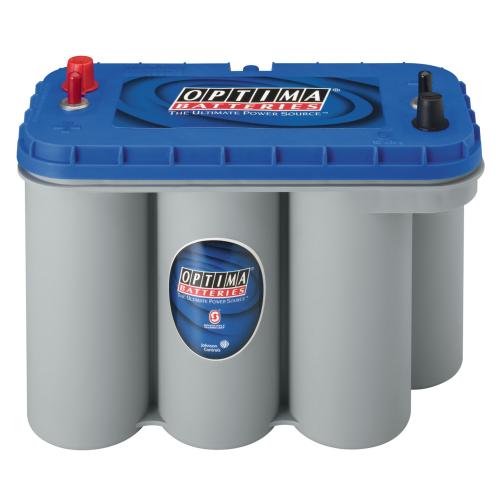

Also do not use lead acid car batteries use AGM batteries, they last longer both in discharging and battery cycles (how many times you can charge and discharge them).
http://mk.factoryoutletstore.com/detail ... y_id=20872
http://www.gandermountain.com/modperl/p ... HwodhdgEUg
