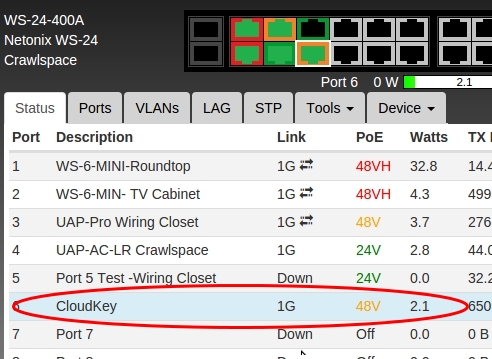

UniFi Cloud Key is a close cousin and works.
