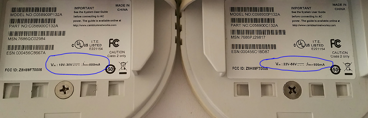

allowed voltage change
ePMP marked details only.PNG (962.47 KiB) Viewed 24621 times
Changing voltage requirements? check this one out, just cost me an ePMP, notice the pretty white one on left, it is now a paper weight.
