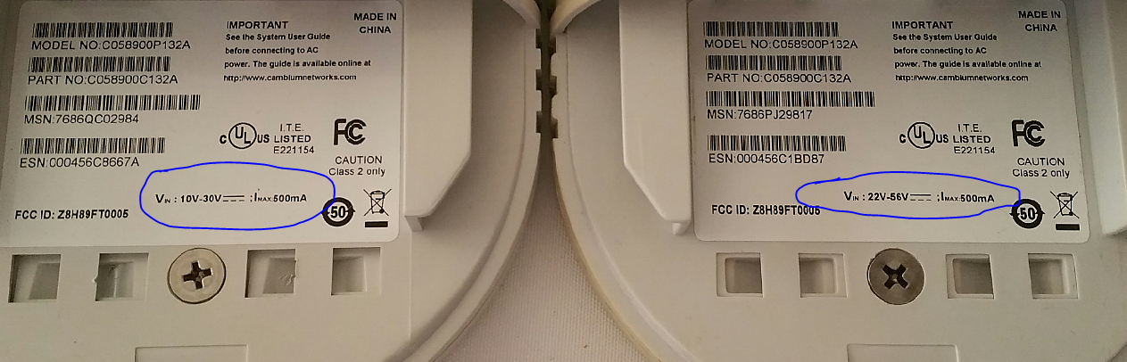

Changing voltage requirements? check this one out, just cost me an ePMP, notice the pretty white one on left, it is now a paper weight.
