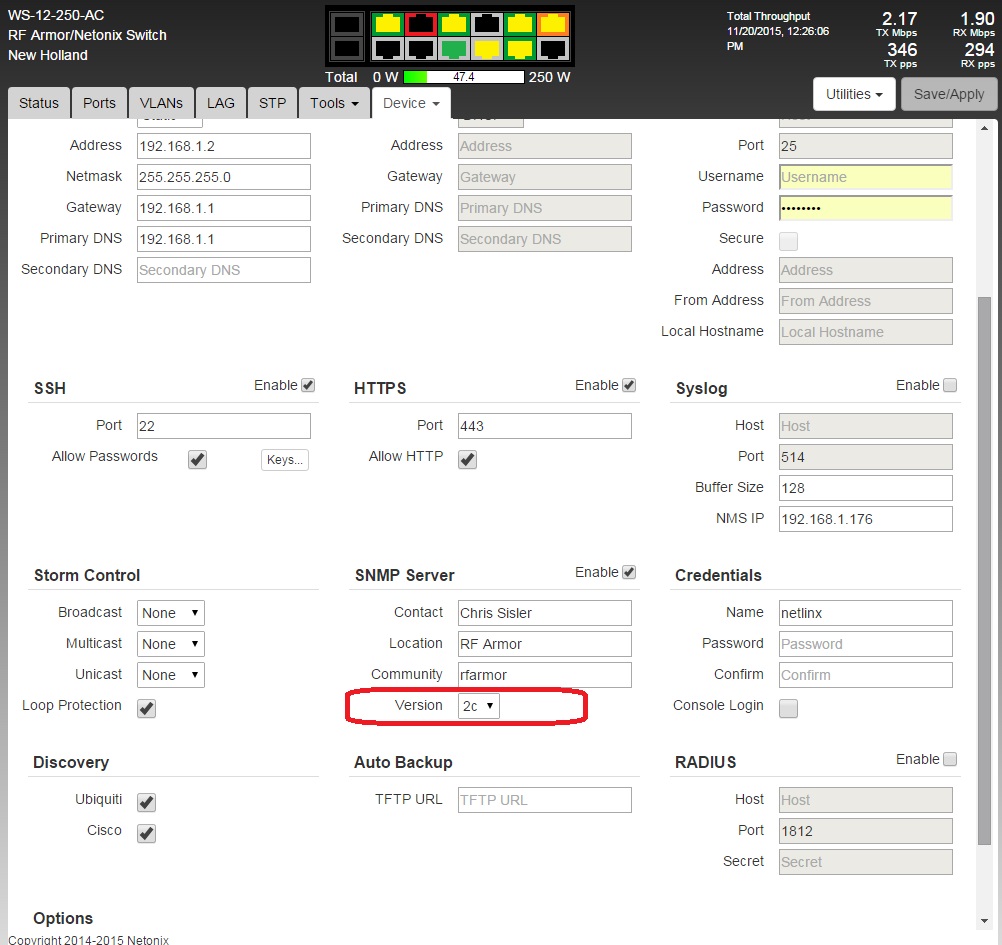

Are you making sure to configure the switch to the proper SNMP version on the Device/Configuration Tab?
Re: Can not get SNMP to work since some 1.3 variant
Posted: Fri Nov 20, 2015 1:28 pm
by mhoppes
Yes,
I have tried both 1 and 2c and neither works. Both will allow Cacti to pull up information about the switch, including interface names and capacity, but the reported throughput counters are always 0.

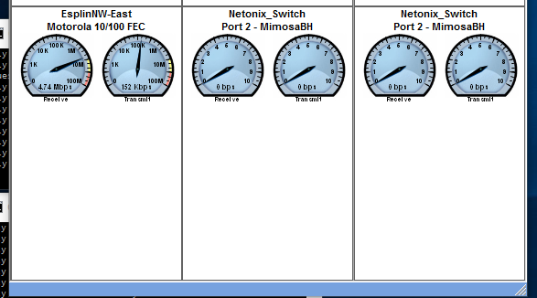

Solar Winds
snmp Netonix.PNG (30.1 KiB) Viewed 18126 times
I made it work with PRTG traffic grapher but I get no traffic (similar results as above) with solar winds
