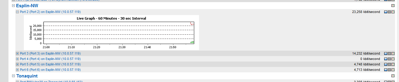

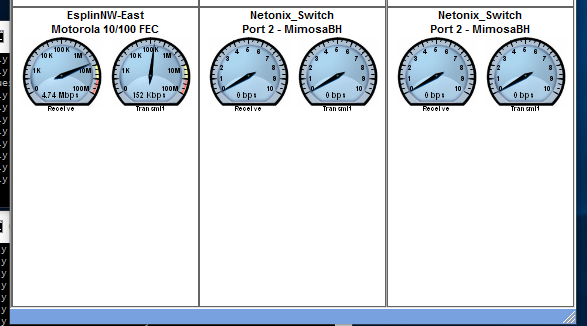

I made it work with PRTG traffic grapher but I get no traffic (similar results as above) with solar winds
- Attachments
- snmp Netonix solar winds.PNG (17.36 KiB) Viewed 18117 times
