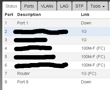

I can see when I connect different UBNT equipment to the WISP switch, that some of it negotiate FC and some of it don't...
Can I enable FC on UBNT equipment not negotiating FC ?
FC on switch.png (8.24 KiB) Viewed 12783 times
Port 2 is PowerBeam AC-500 not negotiating FC
Port 3 is Rocket AC-Lite not negotiating FC
Port 4-5 is Rocket M5 negotiating FC
Port 6 is NanoBridge M5-300 negotiating FC
Port 7 is EdgeRouter X negotiating FC
Actually, I was not aware that the EdgeRouter X had FC enabled by default ? It has v1.8.0alpha2 firmware installed on it....
This switch is scheduled for v1.37 firmware upgrade later this week. It's a very nice firmware version. I have it running on other switches already upgraded.

I m experiencing the same issue with PowerBeam AC-500 not negotiating FC.
I guess that it is AC issue not supporting FC ?!?
Mike A - www.iwisp.gr
Re: Flow control ?
Tue Nov 17, 2015 10:45 am
Mikea wrote:I m experiencing the same issue with PowerBeam AC-500 not negotiating FC.
Yup

Flow Control seems to working for us on Power Beam AC and our WS-6-mini switches...
We did have to go under...network, advanced, interfaces, edit (lan0) and enable flow control for receive and transmit...
