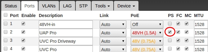

Where do I enable/disable Smart PoE ? I have upgraded some switches to newest firmware, and som of them powers AF5X devices...

Maybe it would help to know it is not "Smart PoE" but rather "Poe Smart" so the clue is in the initials "PS". BTW, hovering over the PS spells it out.

I know that I should disable it for AF-5X. But what is general recommendation ?

jjonsson wrote:I know that I should disable it for AF-5X. But what is general recommendation ?
Turn it off for AFX when using 24VH otherwise leave it on for all other radios. THIS IS ONLY A CONCERN ON 24VH POE option, 24V powering AFX is not an issue
v1.3.8 will fix this issue and then leave it on always as it will then only check for cross shorts.
I pretty well define it out here viewtopic.php?f=6&t=1178
