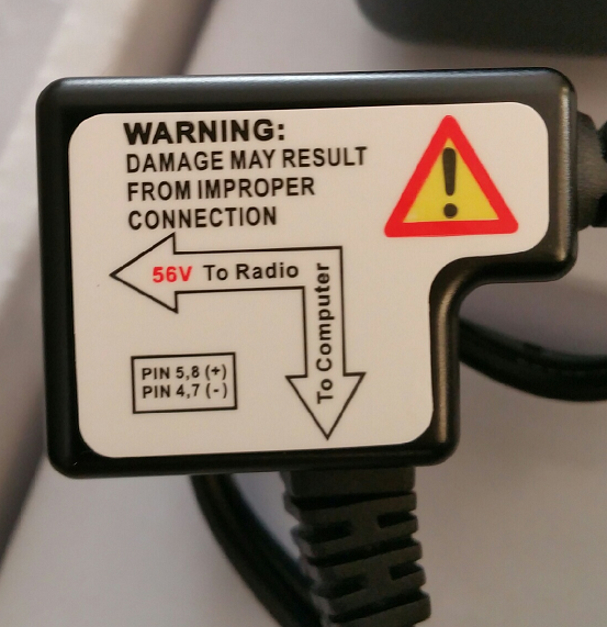

Re: Canopy 430AP
no, the PMP 320, and the PMP 430 have very unique wiring, they won't carry on anything but that POE supply or the CMM4.
if you get into the user manual, or check the power brick it shows the power layout and they apply power in the data pins, and its mixed up too.

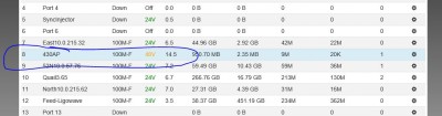

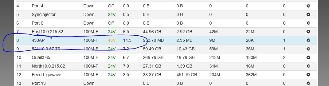

I swapped blue with brown on far end of cat5 and it powers fine from netonix in 48v mode.
crossing pin 4 to 8 on far side only

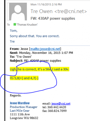

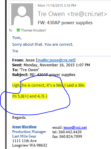

Re: Canopy 430AP
no, this is the only radio that is powered this way, and it does work fine like this,
Its 5,8(+) and 4,7(-)

Re: Canopy 430AP
the ws-6 switch (when powered by POE) will not boot up a Canopy 430AP with the configuration we suggested, keeps rebooting, I think it is too much startup amperage, works fine on dc 250 and ac 250 version,
I think it worked with barrel connection even on the ws-6 but I cannot replicate test as I have to locate another barrel connector,

Re: Canopy 430AP
I tried powering ws-6 mini via a 48VH port on a dc Netonix and on 48VH AC Netonix, as well as a 1.2 amp Ubiquity power supply for the airfiber 24.
Also the radio shows it requires 915 ma which is over the .75 amp in the switch, but I measured it when running on the bigger two switches, and it never went over 15 watts.
Might be a startup amp requirement issue?
