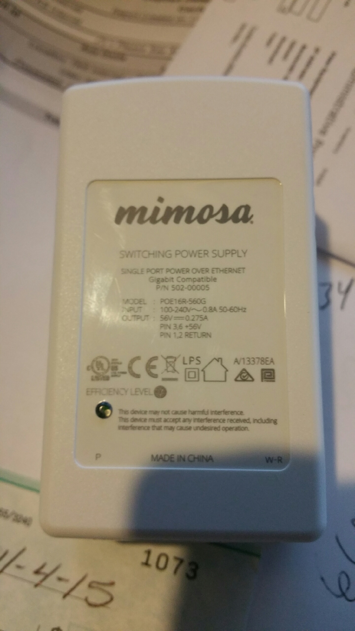

Has anyone actually powered one of these up with one yet? I would hate to fry a radio as the first guinea pig. Worried about power on the extra wires?
Re: Mimosa B5-Lite
For MIMOSA B5 Lite just use regular 48V POE option.
You may have to disable POE Smart if you are using a new version of our firmware.
We may dumb down POE SMart in v1.3.7 FINAL release but for now you will have to disable it on the Ports Tab
Anytime you have POE Smart disabled make sure to run cable diagnostic first and make sure you see no "CROSS" Shorts, you will see shorts and or abnormal termination with MIMOSA radios.
