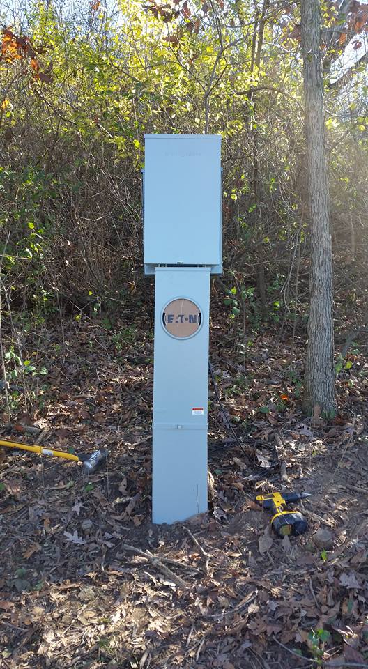

New tower we are doing in a small neighborhood. The local utility is going to bore underground to get power to our side of the road, but the Meter Pedestal is going to sit just off the road. Instead of running power 300ft up the hill ($$$$$$), the plan is to run ethernet cable in a conduit and lay it in the woods and use a WS-Mini at the bottom of the tower.
Will this work ok? 300ft run from our power source, to the WS-MINI at the base of the tower to power 3 24V ubnt radios?

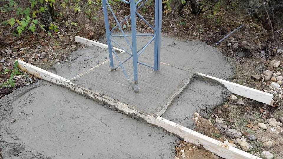

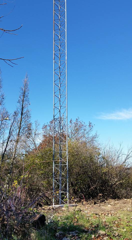

55FT ROHN 45G
