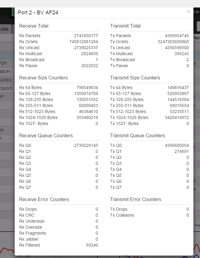

Hello canpandave,
It is best to post your entire ports detail drop down like this so it can be put into perspective.
CLICK IMAGE TO VIEW FULL SIZE
The number of errors in relationship to total number of packets is what you need to look at.
The Rx Filter I would ignore (discussed on other posts).

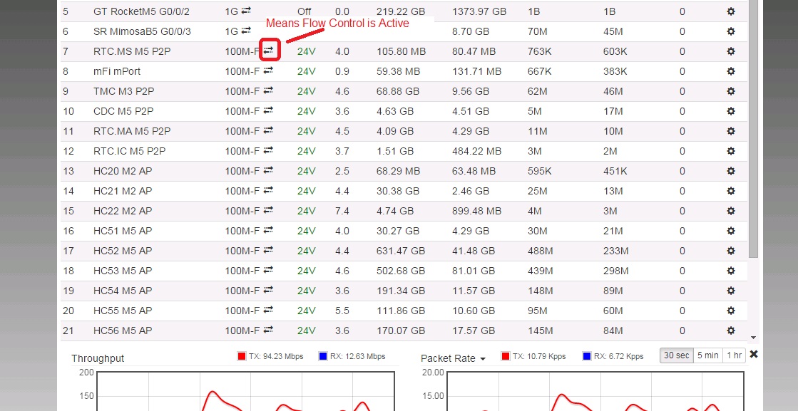

Do you have Flow control enabled on all ports and the devices connected to each port. Put up a screen grab of your Main Status Tab. You can see if Flow control is active on the Main Status Tab.
Flow Control.jpg (201.18 KiB) Viewed 17709 times
