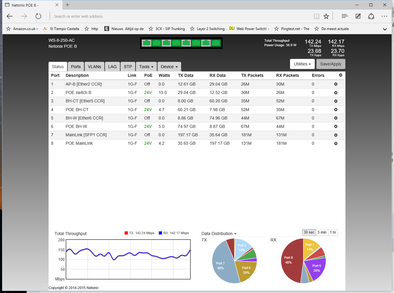

We have one WS-8-250-AC (that is going to be replaced by a WS-12-250-AC as soon as we can get it) that is merely función as a midspan PoE inserter;
Port 1+2 are coupled, 3+4, 5+6 and 7+8. It all works fine.
But, the MT router that connects to Port 7 has a vlan with ID 2000 and service tag enabled that should connect/pass to a transparant bridge working other MT router on Port 8 (That is PoE)
Now all the normal traffic flows fine, but the vlan's on both ends of the port 7+8 switch are not receiving any traffic. So it is not passing.
How to set the config to make it work?

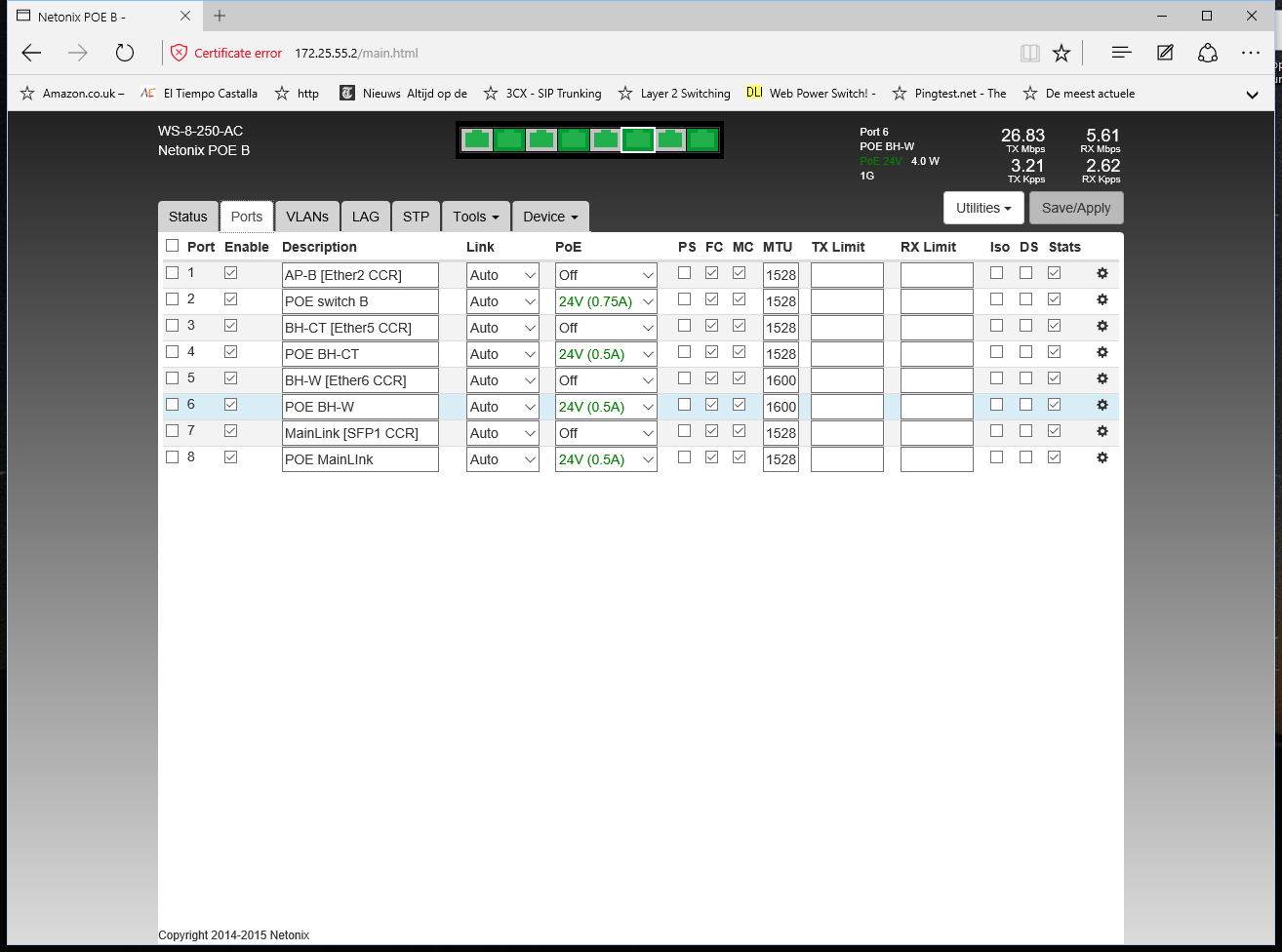

Upgrade to latest version v1.3.3
Make sure the MTU in the switch is set as large or larger than MT L2 MTU of 1586

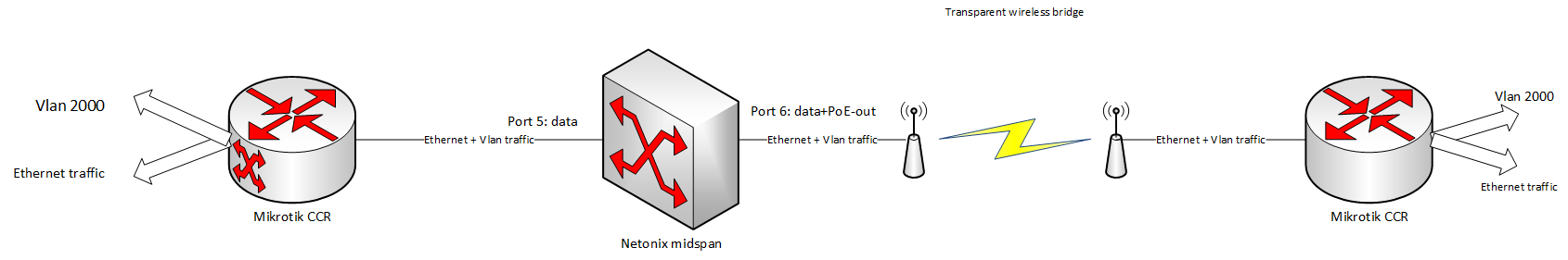

Please make a simple network diagram.

Ok, done the upgrade.
Mikrotik (MT?) L2 MTU is 1590. So in the switch I have to set to 1590? Or higher?

Switch MTU setting both the appropiate ports to 1600 is not changing any...

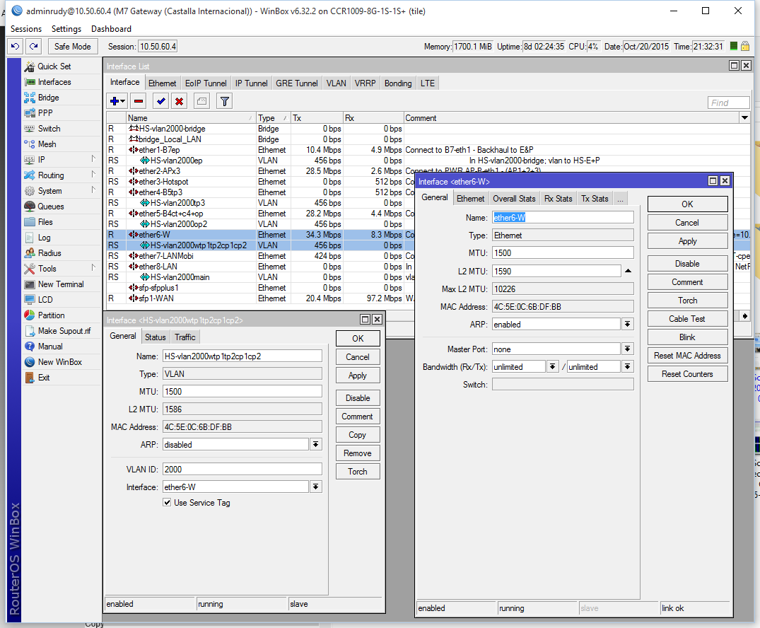

I have rerouted my main vlan bypassing the switch so made a work around for now (I have a 2nd link). But one of the port combi's (2 port mini switch) should still pass this vlan with ID 2000.

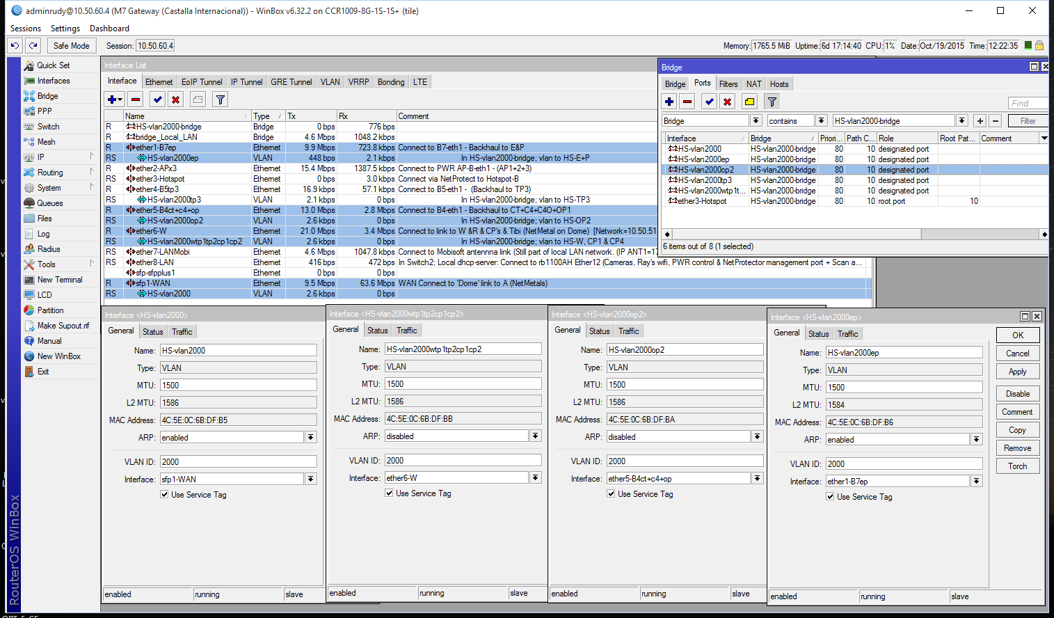

Since a drawing or a photo is not possible in short notice (I am really lousy at that, and no draw program is installed in my PC yet anyway...) I try to explain in simple wordings:
Port 5 & 6 of the switch are midspan PoE where port 5 connects to MT-CCR and port 6 with PoE connects to a NetMetal that creates a wireless link to another units etc.
Port 5&6 are part of a IP network and all ethernet traffic passes normally over this mini switch to and from destination. Just wat I'd expected.
On the ethernet interface of the MT-CCR that connects to port 5 of the switch resides a vlan interface with ID 2000 and service tag enabled.
I understand that the vlan puts a vlan header on top of the ethernet packet and imho these packages should just pass the switch, as they just pass transparently the Netmetal to the other end of the line where it gets stripped again to be separated from the rest of the traffic.
I need to know how to configure the switch so this is happening; vlan packages with service tag add that in a data stream should just pass from the CCR to the NetMetal. It should not even know there is the Switch as midspan poe in the line...
Obviously I make a too simple perception of how it really works. I 'played' with several settings but don't seem to find one that works...

Re: HELP! vlan config help needed
Basically it should be simple:
A router has an interface passing ethernet/IP traffic to port 5 of the Switch. The Switch forwards this traffic to port 6 and puts PoE on the ethernet cable. This cable powers a radio (NetMetal) that makes a link to another radio that connects to end point.
Both the start router and end router have on their interface belonging to this link a vlan interface with ID=2000. (And MT service tag enabled).
The vlan ethernet packages get mixed in the main data stream and should run towards other end where the vlan package get stripped and routed (or bridged to other similar vlan interfaces).
If I put a dumm or Mikrotik Switch or router in switch mode at the place were the WS--250-AC now sits all the packages from the data stream (so normal and vlan packages) will just pass.
But the Notonix is not passing any of the vlan traffic?
We tried several options but since there is no manual and not too many examples in the forum around we are sort of stuck here.....
How to configure port 5 & 6 to have ALL packages passing without any process, stripping or whatsoever....

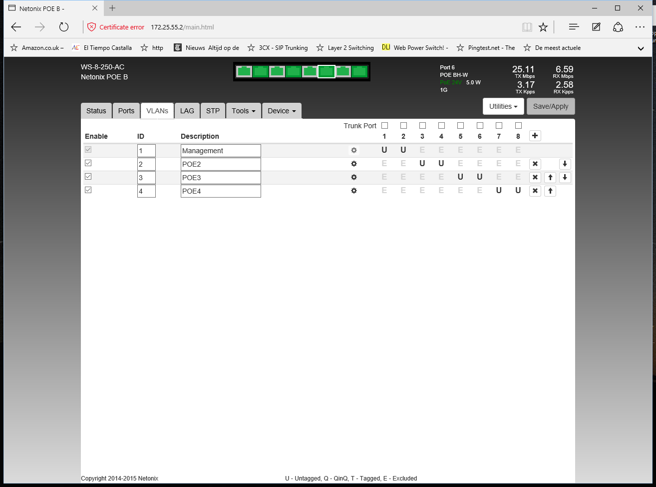

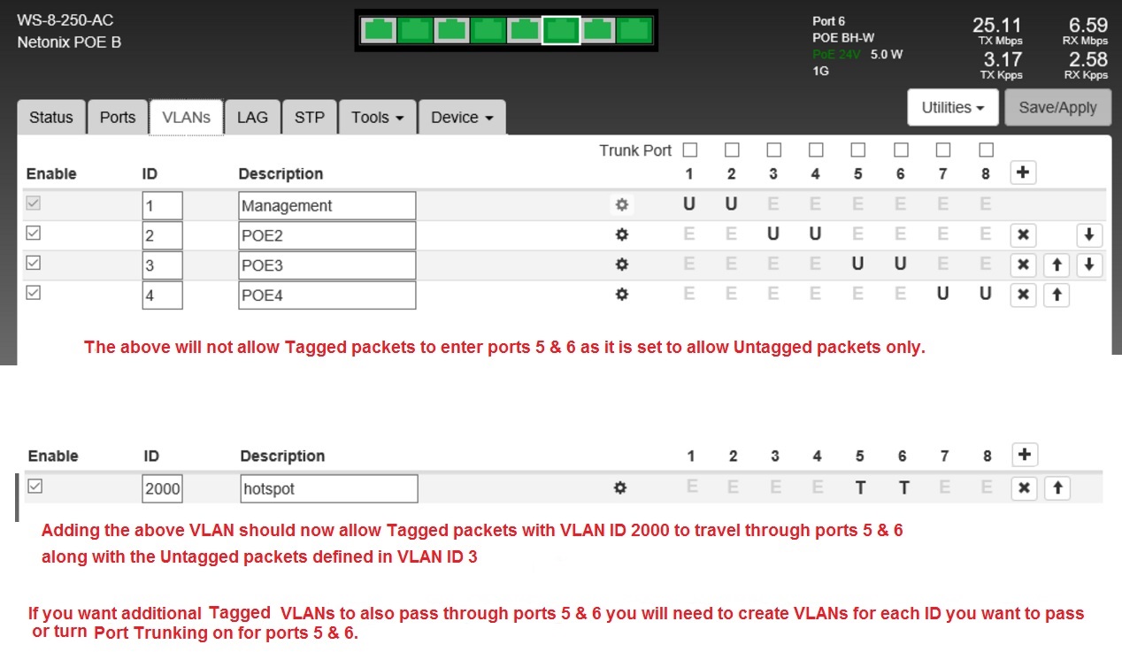

Of course a "Dumb" switch will pass any traffic regardless of VLAN Tags, since a Dumb Switch is VLAN un-aware the port filters are turned off.
We may change the way our VLAN config works in the future but for now it is explicit meaning it "only" allows the packets through that are specified.
In reality you can allow more granular configurations of VLANs such as allow untagged or tagged or both regardless.
I think this is what you want, see below?

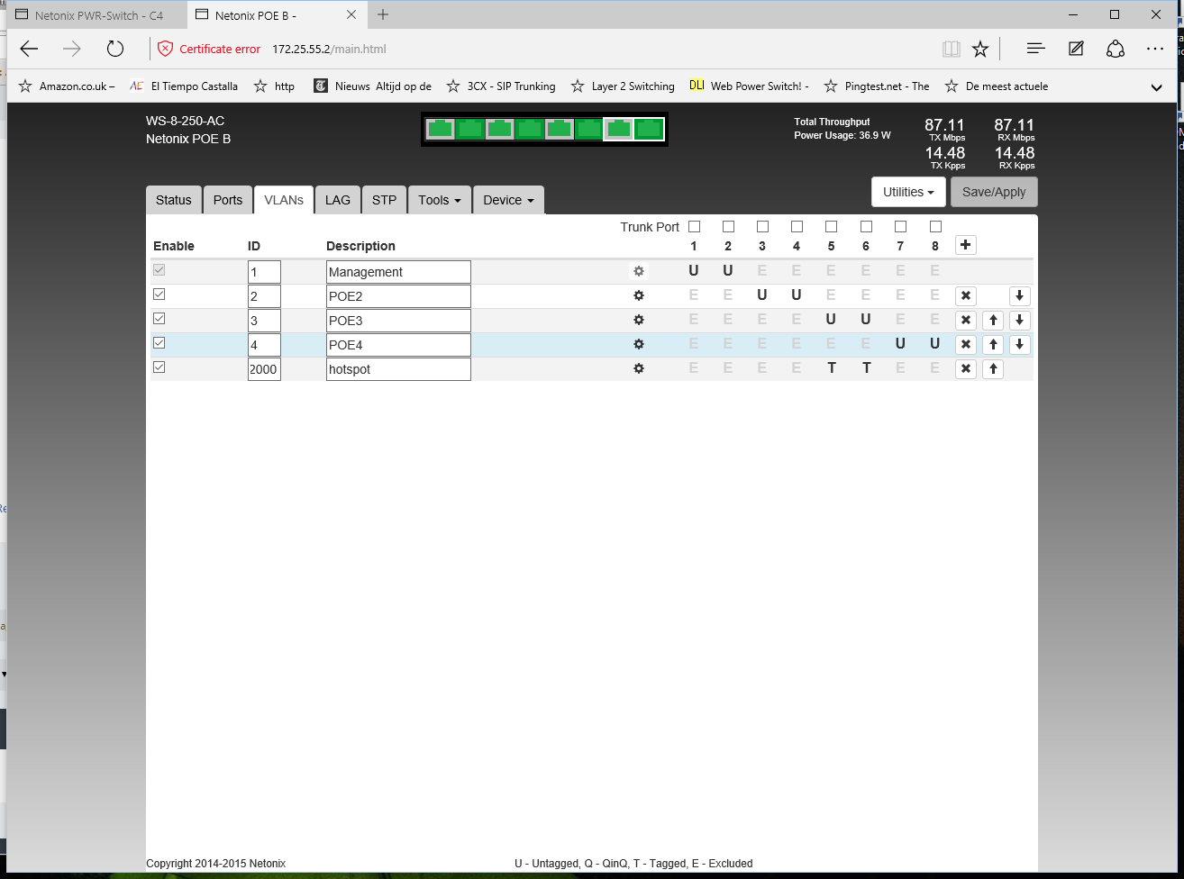

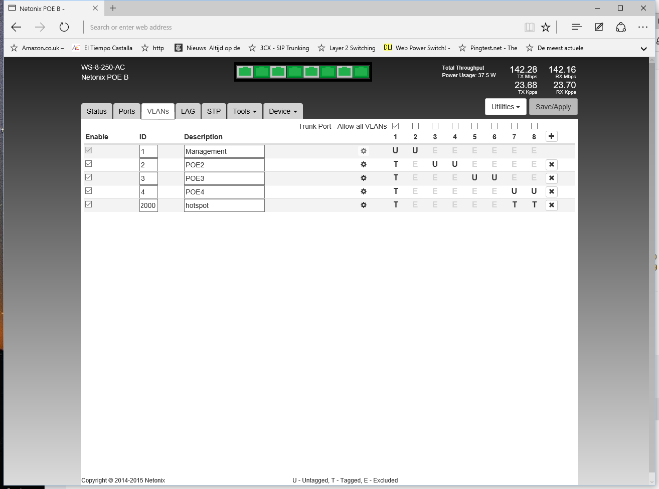

Well sorry, that is exactly what we tried, we figured this is how it should be done. But vlan traffic with ID=2000 doesn't pass from port 5 to 6......??
It cannot be something is wrong in the vlan setup. We swapped the port 5&6 connected link to another lesser important one since we needed the original vlan2000 traffic to pass. This vlan-link inmediately worked when an ordinair midspan box is fit again.
The new link we checked worked, but after putting this in the port 5&6 setup it doesn't anymore..... All traffic pass exept the vlan....

If you look at the Port 5 & 6 "Port Details" do you see any "Rx Oversize" or is the value 0?
