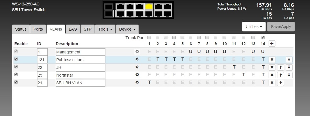

Acclimating myself to the Netonix gear with my 3rd trip up the tower to implement the WS-12-250
First two outings led to lack of success as my VLAN's configured were not right. Reading through forum and reviewing other configs, I am hoping tomorrow will be a success. But, figured it prudent to see if others can take a quick look and review my config plan.
netonix vlan setup.jpg (87.59 KiB) Viewed 9720 times
In short, my BH comes in on port 1 and communicates with Mikrotik on SFP port 14. I have two other BH's on ports 11 and 12 then 4 sectors on 2,3,4 and 5.
Does it look legit?
Thanks for your time.
MT

You're only able to receive/transmit tagged VLAN21 packets on port 1. So if the other end on port 1 is not sending data on vlan21 tagged, nothing comes into the switch...
You probably need to untag port 1.....

Thanks for responding. The other end is tagged 21 but I'll try it both ways on next climb.
