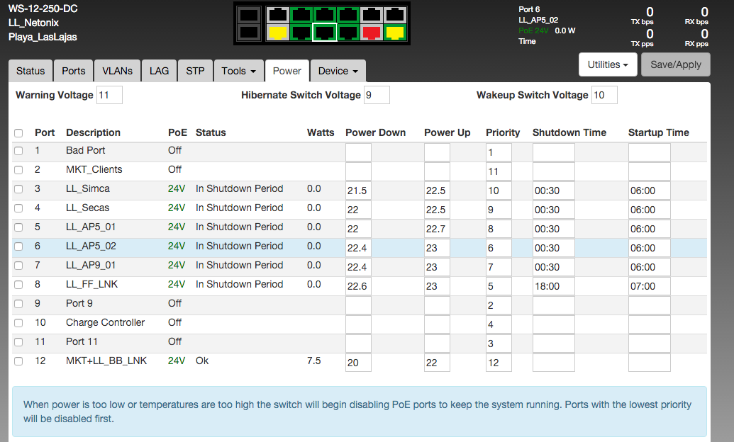

I just tried again, same result with different time format
Oct 9 14:49:35 UI: Configuration changed by 192.168.200.12
Oct 9 14:49:35 UI: Port 3 Shutdown_Time: changed from '' to '00:30'
Oct 9 14:49:35 UI: Port 3 Startup_Time: changed from '' to '06:00'
Oct 9 14:49:35 UI: Port 4 Shutdown_Time: changed from '' to '00:30'
Oct 9 14:49:35 UI: Port 4 Startup_Time: changed from '' to '06:00'
Oct 9 14:49:35 UI: Port 5 Shutdown_Time: changed from '' to '00:30'
Oct 9 14:49:35 UI: Port 5 Startup_Time: changed from '' to '06:00'
Oct 9 14:49:35 UI: Port 6 Shutdown_Time: changed from '' to '00:30'
Oct 9 14:49:35 UI: Port 6 Startup_Time: changed from '' to '06:00'
Oct 9 14:49:35 UI: Port 7 Shutdown_Time: changed from '' to '00:30'
Oct 9 14:49:35 UI: Port 7 Startup_Time: changed from '' to '06:00'
Oct 9 14:49:35 UI: Port 8 Shutdown_Time: changed from '' to '18:00'
Oct 9 14:49:35 UI: Port 8 Startup_Time: changed from '' to '07:00'
Oct 9 14:49:37 switch[1374]: Disabling PoE power on port 3 due to Shutdown Period
Oct 9 14:49:37 switch[1374]: Disabling PoE power on port 4 due to Shutdown Period
Oct 9 14:49:37 switch[1374]: Disabling PoE power on port 5 due to Shutdown Period
Oct 9 14:49:37 switch[1374]: Disabling PoE power on port 6 due to Shutdown Period
Oct 9 14:49:37 switch[1374]: Disabling PoE power on port 7 due to Shutdown Period
Oct 9 14:49:37 switch[1374]: Disabling PoE power on port 8 due to Shutdown Period
Power tab attached

Eric Stern - Employee
- Posts: 532
- Location: Toronto, Ontario
- Been thanked: 130 times
Re: Feature request?
There was a bug parsing the start and stop times. Basically it saw 06:00, which is 6am, as 6pm.
This will be fixed in 1.3.5.
