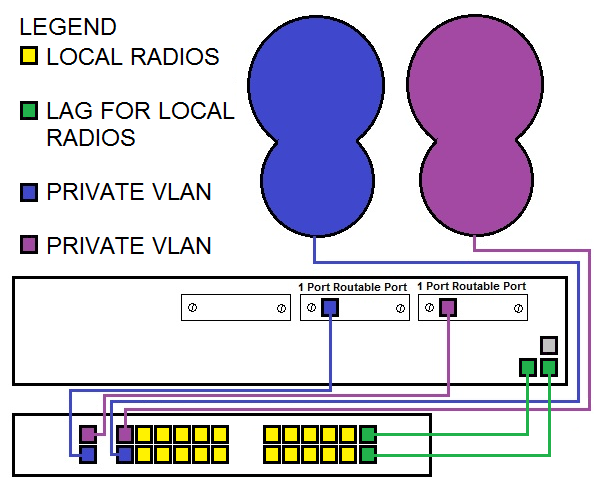

Posted: Tue Oct 06, 2015 12:27 pm
Tower Setup.png (82.22 KiB) Viewed 34897 times
This way traffic going into the tower destined to the next tower will not be affected but the pause frames generated by the "local" radios on that tower serving as AP's or private PTP links to higher end customers.
Also since all the "local" radios on the tower go through a LAG to the router there is a 50/50 chance that the pause frame issued because one AP's port buffers are full will even affect other local radios/streams on that tower as the switch will issue the pause frame to only one of the interfaces in the LAG, the one that is feeding that AP at that time.
I go over this in the WISP Switch movie on You Tube: https://www.youtube.com/watch?v=8JvBEAD4MFM
