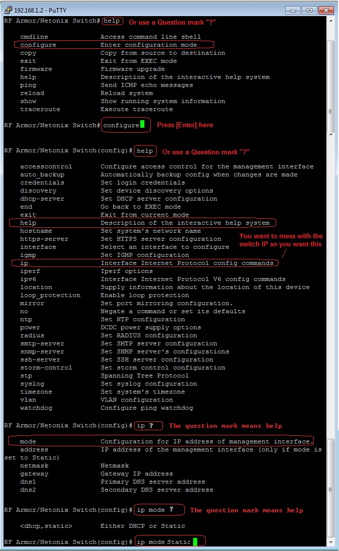

Sat Oct 03, 2015 3:19 pm
You will be in the CLI when you console in
Just use the "?" for help
I would assume you would want to look at the running config
Here is a screen grab of a recent topic where the user could not seem to find how to change from DHCP to Static mode in the CLI so I helped with this picture of how easy it is.
CLICK IMAGE TO VIEW FULL SIZE
CLI IP Mode.jpg (237.57 KiB) Viewed 33072 times
