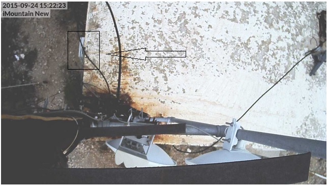

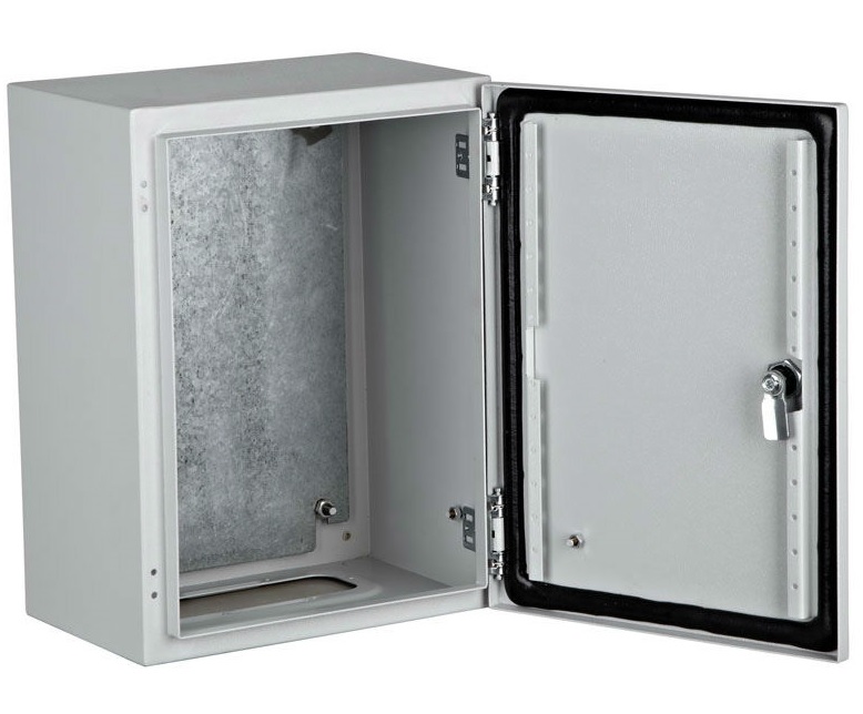

sbyrd, i have installed my Netonix Switch on a tight IP65 Metal box
like the one in this photo:
That is mounted on the ouside concrete wall
look in the following photo:
The installation is in Greece (for enviromental ref)

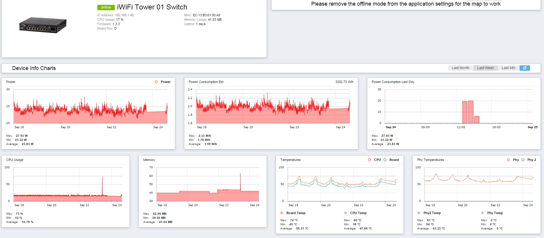

and the temperatures of the switch can be seen in the following screenshot of iWiSp:
So for me there are no risks or concerns about this type of setup!
