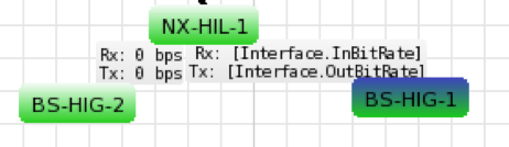

Here's the screen shot from The Dude showing that the interfaces just disappear and add themselves in again (using SNMPv2).
With v1 they stay all the time.

It works, but it cycles from working and showing the interface, to not working?
Within the switch logs I still see loads of these errors: could not handle packet from UDP client x.x.x.x:26072: Bad address

The only time I've seen this error is when The Dude is sending v1 packets and our switch is configured for v2c. Try installing 1.3.2 and change the SNMP version to v1 and see if that helps.
This thread is at this link: viewtopic.php?f=6&t=985&p=7534&hilit=SNMP#p7534
I am guessing here that the Dude is sending v1 packets to the switch which is configured for SNMP v2?
