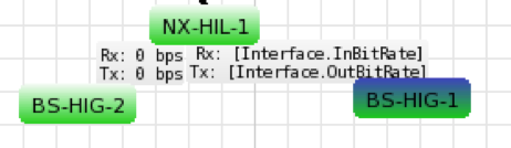

Here's the screen shot from The Dude showing that the interfaces just disappear and add themselves in again (using SNMPv2).
With v1 they stay all the time.

Re: SNMP not working
Fri Oct 02, 2015 1:27 pm
There are other people using SNMP v2 as in this post?
viewtopic.php?f=17&t=1053&p=7937&hilit=snmp#p7921
I know we are not reporting the voltages that the guy wanted in the above post which is going to be fixed in v1.3.5
Or this guy asking that report some additional information but other than that he is using SNMP v2?
viewtopic.php?f=17&t=1046&p=7854&hilit=snmp#p7854

It works, but it cycles from working and showing the interface, to not working?
Within the switch logs I still see loads of these errors: could not handle packet from UDP client x.x.x.x:26072: Bad address
Fri Oct 02, 2015 1:42 pm
Well you're being more descriptive now! :ak:
I did a quick search of the forums and cam up with this post:
Eric Stern wrote:Dude probing switch causes errors on the Netonix
Sep 6 14:49:10 mini_snmpd[2903]: could not handle packet from UDP client x.x.x.x:26072: Bad address
Sep 6 14:49:34 mini_snmpd[2903]: could not handle packet from UDP client x.x.x.x:26072: Bad address
The only time I've seen this error is when The Dude is sending v1 packets and our switch is configured for v2c. Try installing 1.3.2 and change the SNMP version to v1 and see if that helps.
This thread is at this link: viewtopic.php?f=6&t=985&p=7534&hilit=SNMP#p7534
I am guessing here that the Dude is sending v1 packets to the switch which is configured for SNMP v2?
