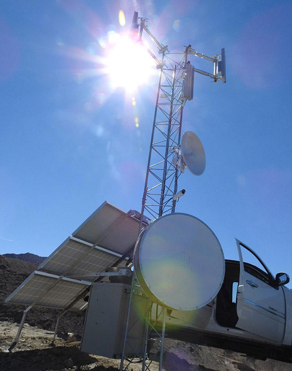

My first WS-12-250DC is running perfect at my brand new solar site!
