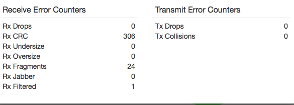

A little more investigation and I'm seeing CRC errors on the TX side of the fiber from the remote end.
Is there a way to diagnose this more? See light levels/etc on the SFP modules?

Re: Odd throughput issue with fiber SFP
Seem like the MTU error but normaly, it show Rx Drops. Can you try MTU to 1528 ? Old firmware add MTU at 1500 and it could be problematic. Also, have you try both mode of Link ? 1G and auto ?
No. I was about to try auto vs 1G and ran out of time today. The other idea I just came up with is we might be using MM gbics on SM fiber.
I have no idea how that would manifest itself.
An MTU issue wouldn't cause CRC errors would it?
I don't think so but I add the same kind of beavior to be able to ping but not to browse remote device webui with too much low MTU and it should be higher than 1500 on SFP anyway.
