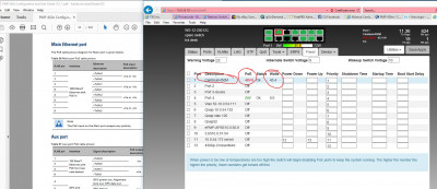

Cisco Aironet 1572EAC works but with crossover Ethernet cable!! and use 48VH on the switch.

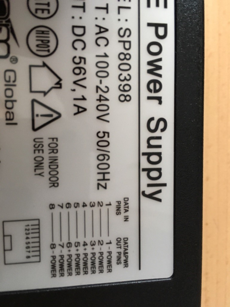

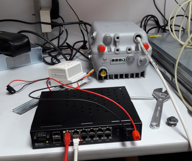

is it possible to power Bridgewave 4gflex?

is it possible to power it with netonix?

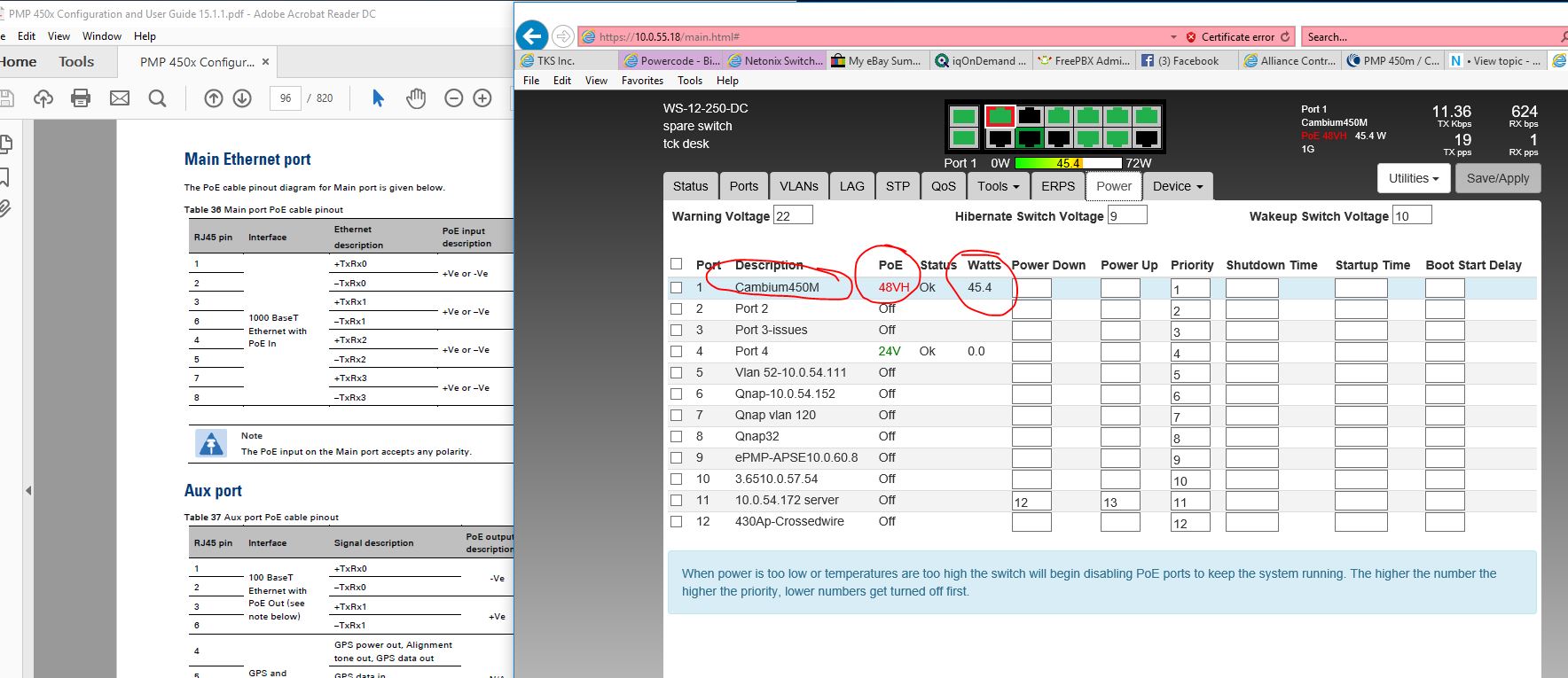

450Medusa running on 48VH with straight cable,
