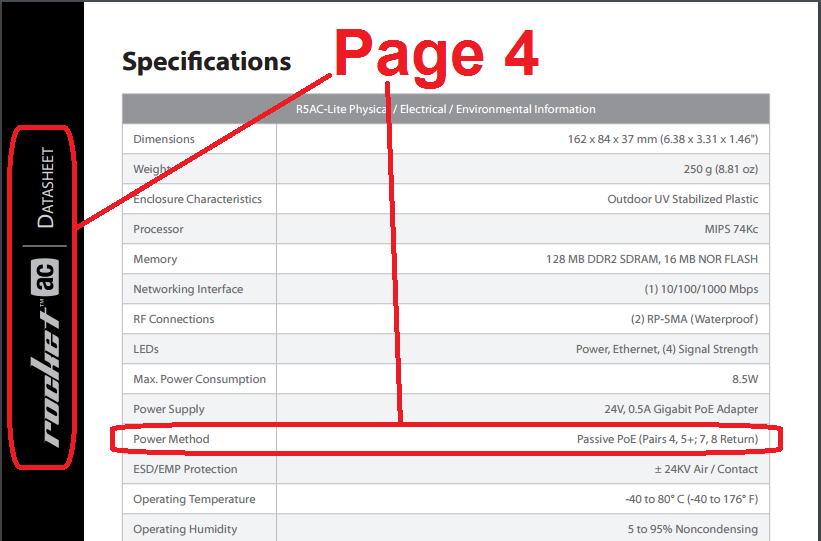

rgunderson wrote:Thanks! My confusion is from the fact that the Rocket AC unit requires power on all 4 pair.
I do not believe this to be true Daniel Jackson?
Why do you believe the Rocket AC or any airMAX AC radio requires or even accepts power on all 4 pair?
Can you provide proof of this assertion and or self proclaimed fact you state to be true?
Now I am no "Rocket Scientist" :rofl4: but these were the steps that I went through to come to my conclusion:
Step 1) I download the PDF for the Rocket 5 AC Lite.
Step 2) I actually read the PDF looking for POE specs.
And this is what I found:
I understand your confusion now....NOT :ak:

Even easier Confusious - just look at the POE that comes with the unit :P
I did that but it was a quick glance - my mistake. Either way, because I only have 1 link using the AC units I am not very familiar with them so I felt it was best to confirm with you.

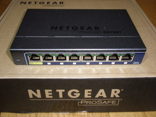

Netgear ProSAFE 8-Port Gigabit Switch GS108Tv2 works with 48V
