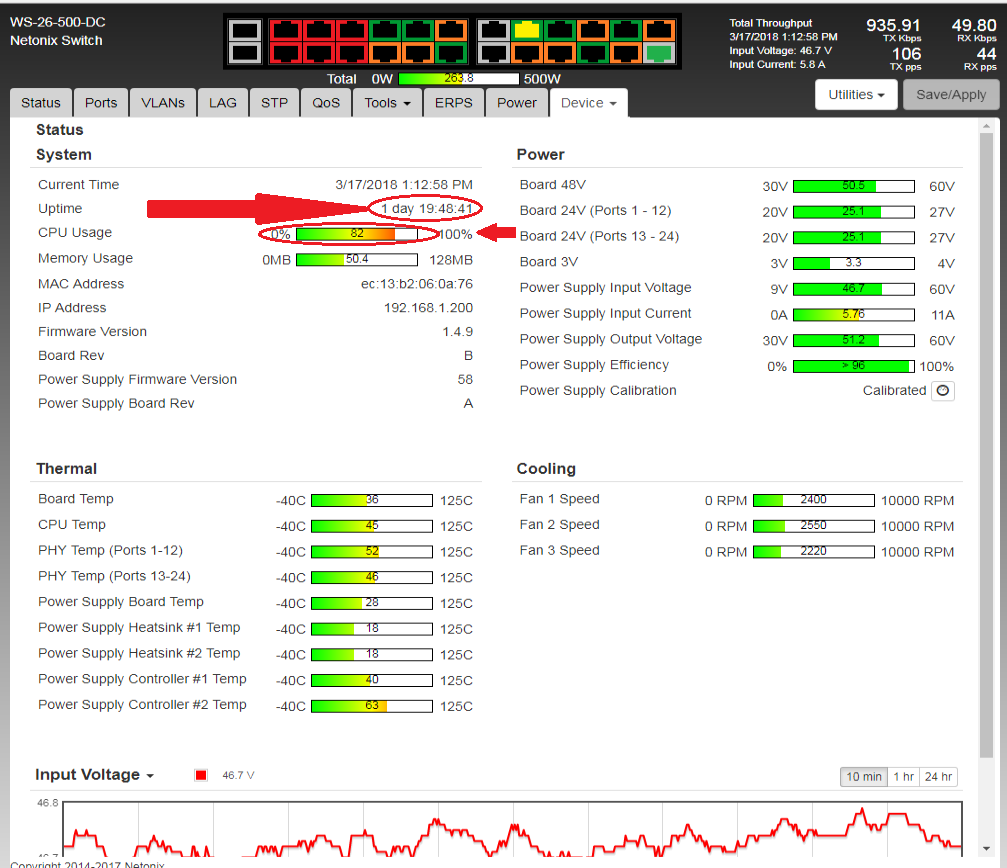

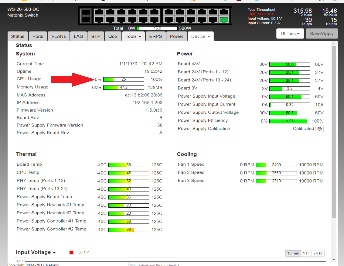

We have been testing the WS-26-500-DC sent back from Intellipop and so far no reboots up time 1 day 19+ hours.
We have changed the input voltages from 24V to 52V during this test with no reboots but the CPU Utilization is way too HIGH.
We are "suspecting" that this may be the cause. Eric has optimized the code to reduce CPU to 30% +/- which we think will greatly help.
A theory of what might be happening is the CPU is getting bogged down and possibly not responding to the watchdog which forces a reboot or other adverse issues resulting in a reboot.
The fact that it is not rebooting in our LAB even with HIGH CPU is probably that there is nothing else going on so the high CPU is not an issue.
Anyway below you can see Intellipops switch with HIGH CPU usage and under similar POE load as he had deployed it and also another unit with the new optimized code with LOW CPU utilization.
So anyway will be hopefully releasing v1.5.0rcX today or tomorrow.
v1.4.9
v1.5.0rcX
