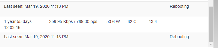

I uninstalled and re-installed an older version (8.9.0) of node.js on my Win10 machine where manager is installed. The scheduled upgrades do seem to be working now, however the status of the switch after the upgrade is not stuck at rebooting, and last seem over 12 hours ago.
Any ideas on this?
Any ideas on this?
- Posts: 1080
- Been thanked: 210 times
Can you provide an image or screenshot of the issue?

The scheduled update was over 12 hours after the time in the image, and both devices updated successfully.
sakita - Experienced Member
- Posts: 230
- Location: Arizona, USA
- Has thanked: 112 times
- Been thanked: 90 times
I have seen the same thing before and have to click on the pencil and disable polling and then do it again and re-enable it to get the manager to display status again.
Dawizman - Experienced Member
- Posts: 174
- Has thanked: 17 times
- Been thanked: 31 times
It seems that works. Less than ideal though.
