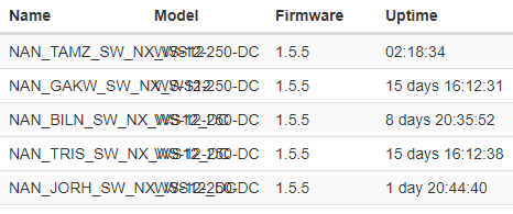

Hi,
In addition to what was asked, I would like to inquire if there is any way to adjust the columns in the netonix manager to avoid overlapping of words in different columns.
Thank you.

Cynchie, right now column widths are fixed. I will look into making them adjustable.

Thank you Stephen. That will be very helpful.
