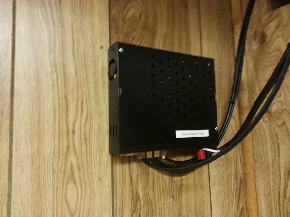

Ok got it. After my first post I decided to go ahead and test one on the tower here at the shop. It's got 3 rocket TI's plugged into it and so far so good. I really like the real time graphs per port. Very handy. I also really like the PIE chart that shows you which ports are using what. Very cool. I'll have to start working on some dude notifications for various issues. I mounted mine temporary style to a wall for the time being. There are 2 holes on opposite corners that made good zip tie holders until I can get a shelf put over there. :)
What is the temperature that will shut the unit down and which thermal device will activate that? I see several parts of this device being monitored. I'd like to setup the Dude to monitor the one that would shut the unit down and alert me if we approach that.
Re: DC Switches
All the thermal sensors are used to adjust fans and to turn off POE ports if needed.
Those holes are to screw it to the wall - we included 2 screws for just that

Don't make fun of our 70's wooden walls!
- Attachments
- 20150831_152106.jpg (92.63 KiB) Viewed 21309 times
Re: DC Switches
Looks Good - Thanks man!
I am old enough to remember a LOT of paneling in the 70's-80's!
