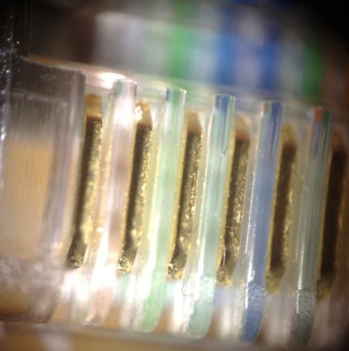

Only draw back that the field installer and I can see if you get the patch cables least bit out of wack or move them, bump them etc. the radio loses power from the POE port. :eek:
Once we got them in place and not moving the wiring around, they are working fine.

Torolan wrote:Only draw back that the field installer and I can see if you get the patch cables least bit out of wack or move them, bump them etc. the radio loses power from the POE port. :eek:
You may need a new crimper or another brand or Crimp ends. They should not flake out once they click into place.
Examine them closely under a magnifier for crimping that is too deep.

Yea I would look at a new crimper or look at your ends?
We have these at all our towers and they are not that touchy at all, you can "bump" the cables just fine?
We use RF Armor and or UBNT RJ45 ESD crimp ends as well as pre-made jumpers.

Most of these are factory made patch cables, coming over from the lightning arrestors. Though we made up patch cables, for the stuff going to the Motorola gear.

Torolan wrote:Most of these are factory made patch cables...
About a decade ago, I was doing a desktop PC churn and started having issues with flakey network on most of them. The first thing I thought was that it was a driver issue and it was later that I started looking at the jumpers with suspicion. Turned out all the jumpers were from the same lot and I went through and tossed a few hundred of them. QC tolerances can creep in and it was only because the spring contacts on the new NICs were marginally larger gauge that the tolerance issue manifested.

Yea we had a lot of jumpers at the Diller Ave Tank that if you bumped them they might not link up.
And this was when we had 3 TOUGHSwitches not a WISP Switch at the tank.
They were CAT6 jumpers, replaced them with cheaper CAT5e and the problem went away.

Yeah It was super cold yesterday as well, so I think that posed issues with it as well. I think it is how are patch cables are in in the boxes. I need a warmer day to redo the boxes and the time to take it down for 30 minutes to an hour, and we will rerun new patch cables over to the new switches. I will send you pics when we get them all dressed up.
We did these change overs to the new switches in 5 to 10 minutes, when it was 14 degrees out side. Which included us ripping out all the old POE's, with as little down time as possible since these were live in use towers.
So far running 24 hours with no issues.
