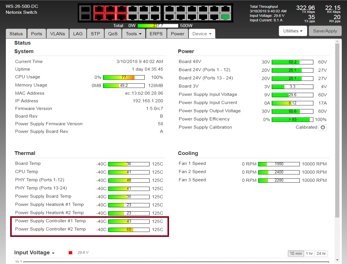

Do you possibly have a SNMP monitoring of these switches?
Would be real curious to look at the controller temps leading up to the reboot

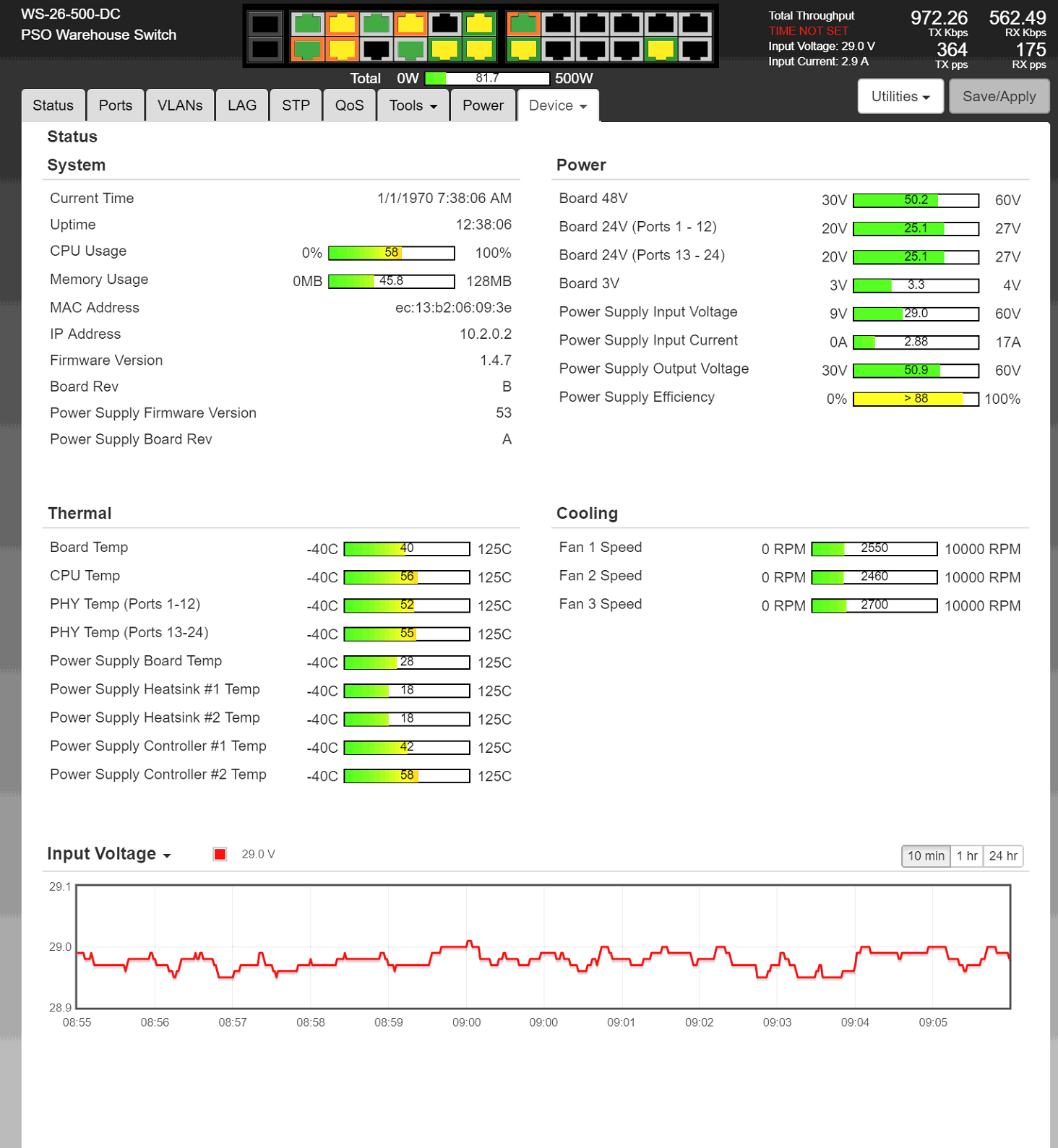

Could post up a screen grab of the Device/Config TAB please.

Also wanted the Device/Config TAB
Also please like to request main Status TAB
