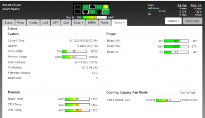

Are there any posts newer on this subject? I have a WS-10-250-AC with the same issue. I have read all the suggestions in previous posts and tried all. I have changed ports, then replaced cable and tested cable, then changed radio. I have also replaced the switch. The radio on that port is a Rocket Prisim 5 AC Gen 2 on a sector antenna. I also reworked all the grounding where service entrance ground, switch ground, and tower ground are all bonded together. Nothing has slowed it up it's doing it very frequently causing jumpy, jerky connections on the sector.
Aug 10 21:05:32 STP: msti 0 set port 8 to discarding
Aug 10 21:05:33 STP: msti 0 set port 8 to learning
Aug 10 21:05:33 STP: msti 0 set port 8 to forwarding
Aug 10 21:05:36 STP: msti 0 set port 8 to discarding
Aug 10 21:05:37 STP: msti 0 set port 8 to learning
Aug 10 21:05:37 STP: msti 0 set port 8 to forwarding
Aug 10 21:05:48 STP: msti 0 set port 8 to discarding
Aug 10 21:05:49 STP: msti 0 set port 8 to learning
Aug 10 21:05:49 STP: msti 0 set port 8 to forwarding
Any help would be appreciated
