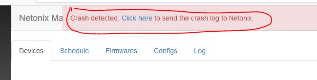

My manager always says "Crash detected. Click here to send the crash log to Netonix." Clicking the link doesn't seem to help, and rebooting the server does not help.
What am I missing?

Is the Netonix Manager running on the same machine your accessing it from?

Stephen wrote:Is the Netonix Manager running on the same machine your accessing it from?
No, it is running on a virtual machine specifically for the Netonix Manager.

Can you give me more details?
What type of OS is it?

Stephen wrote:Can you give me more details?
Sure -
OS: Ubuntu 18.04.3
VM: Container in Proxmox 5.4
RAM: 1GB
Drive: 8GB
Everything seems to work fine. The only issue is that it always shows something crashed, and clicking the link does not help.
- Posts: 1079
- Been thanked: 210 times
If you refresh the web page. Does the issue continue?
