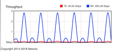

Is it normal for Netonix manager to generate high traffic (traffic returning from the switches to it)?
The attached graph shows ONLY Netonix-Manager traffic --- shutting down the app stops this traffic completely.
This particular one manages about 20 switches...

If you're Netonix Manager is watching the status of all of those switches then it has to continually request a json file from each of them that contains the status details of that switch. If this is too cumbersome on your network. You can reduce the impact editing a few of the switches and turning off the "Monitor" option. Which will prevent the NM from continuously polling them but won't prevent you from doing upgrade's, accessing the web UI etc.

Na - this started recently... something is wrong...
Also - seriously, a peak of 3mbps for a second or so, means a VERY large json file even if divided by 20....
Assuming you are correct, that would be devastating in my other network where NM is monitoring ~100 switches, and it does no such thing.
It would also suggest a pretty poor design -- why pull everything every second, where you should only pull diffs (rsync like) -- I'm fairly certain Eric would not have released such functionality... You must be guessing... or if indeed it work this way, the json must be so tiny (around a single packet or so), and not create such traffic under normal conditions...

Well, let's check something, about how large are the log file's on the switches being monitored? This is something we've been watching. It's possible depending on what's happening the NM might be trying to pull in the log file and of course, over time these progressively grow. Are the log files on the switches very large? And if they are, if you clear them - does that stop these spikes?
