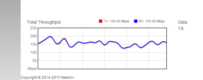

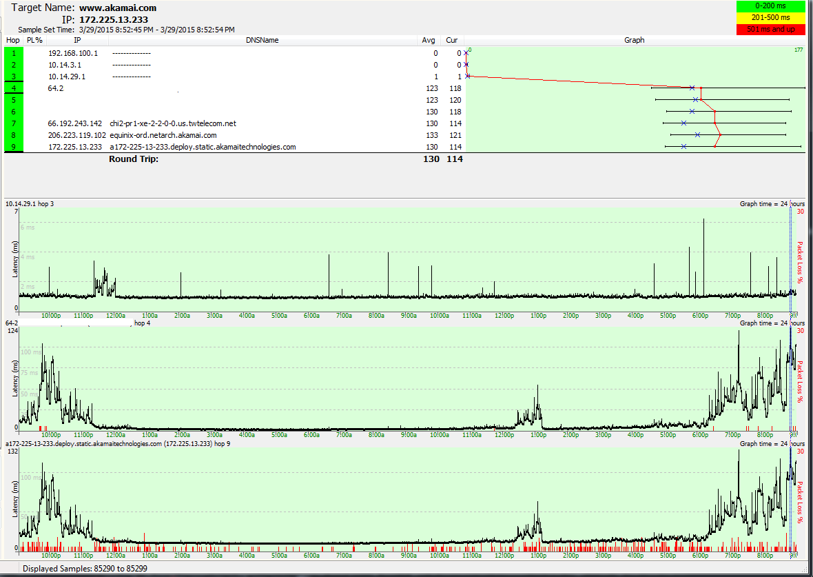

I am getting high latency during my peak times. During the day I can get 8ms to 8.8.8.8, now I am getting 90ms.
My provider first thought the AF5 link between him and myself was maxing out. I observed it now doing 80mbps.
During this time my latency is between 80ms-100ms to 8.8.8.8, google.com, akamai.com etc.
I then was able to login to that AF5 link, and via the GUI I can ping the slave from the master side and the average ping out of 50 pings was 1.8ms.
So, the link itself is not being maxed, but, I still do show RX DROPS counter rising, on my Netonix. Would those RX drops cause higher latency during peak usage?
My provider is not being helpful at all. this happens every night, he acknowledges it, says he will look into it, but nothing happens, and it is only getting worse as we add more subs. So I am stuck here trying to figure this out, while the problem is likely not even on my network. Basciily anytime the link pushs 40mbps or more, the latency climbs into the 80ms range, if not about 100ms. Other times, it is almost rock solid under 10ms.

Re: Port Errors
Sun Mar 29, 2015 9:39 pm
No, Rx Drop would not be your cause.
My guess is it is your provider since this is happening at PRIME TIME, our switches do not care if it is prime time or 2AM so if your net is fast at 2AM then slow at prime time I would say I would talk to your provider.

Re: Port Errors
Sun Mar 29, 2015 10:09 pm
:agree:
That is pretty much what I think I have narrowed it down to.. He is on this forum, as he runs a larger wisp, but still no resolve here..
Hop 3 is my core, hop 4 is his core, but there is something in there that he is having major issues with.. Nothing else I can do besides sit here and watch.. or shop for other providers.. All of my customers are on this and dealing with this same crap right now.. /rant
