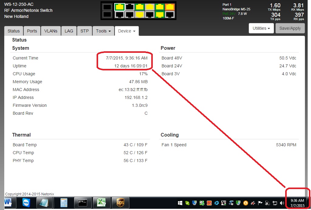

Not sure why your timestamp is off other than you either have the NTP service or the switch IP address configured wrong or the switch does not have access to the internet maybe because of firewall rules or something. The NTP service is working fine for me and many others. see picture below
My guess is you are sitting behind a router and the switch can not get out to the internet to get the time.
I would suggest going to the CMD line of the switch and verifying that you can ping a public IP address and find out why the switch is not getting out to the real world internet.

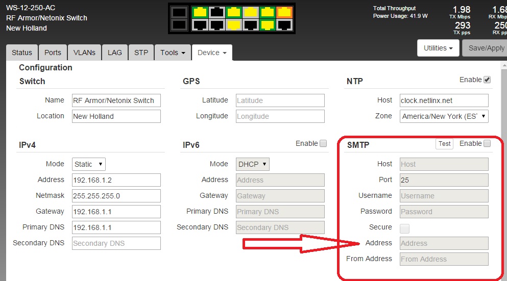

Your log you posted is not formatted, very hard to read. The Email log button is not broken it works fine, it does not ask for an email address to send the log to to it uses the email address configured on the Device/Config Tab. see picture below
If you do not have the SMTP properly setup under the Device/Configuration Tab with valid email credentials and or an SMTP server that will accept relaying from it will NOT email the log.
HOWEVER THAT IS A GOOD SUGGESTION FOR A FUTURE SOFTWARE CHANGE AS THE USER WANTING THE LOG MAYBE AT A DIFFERENT EMAIL ADDRESS THAN THE SWITCH SENDS ALERTS TOO.

sirhc wrote:Not sure why your timestamp is off other than you either have the NTP service or the switch IP address configured wrong or the switch does not have access to the internet maybe because of firewall rules or something. The NTP service is working fine for me and many others. see picture below
I would suggest going to the CMD line of the switch and verifying that you can ping a public IP address and find out why the switch is not getting out to the real world internet...
sirhc wrote:...4) determine if the switch can indeed get to the internet to update the time. You can do this by going to the console and typing CMD [Enter] which will drop you to the linux shell and ping 8.8.8.8
Yes, indeed my switch is sitting behind a router. Will try what you said.

sirhc wrote:If you do not have the SMTP properly setup under the Device/Configuration Tab it will NOT email the log...
It also conveniently, did not tell me there actually ain't no email going anywhere (since I indeed, not have any SMTP server configured in the device's configuration). An error prompt may be nice?
I am able to ping Google's DNS server via the switch's cmd-line:
