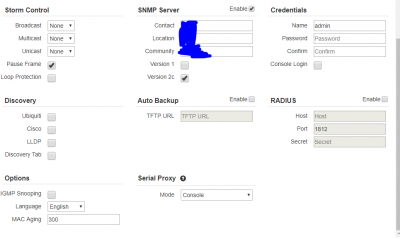

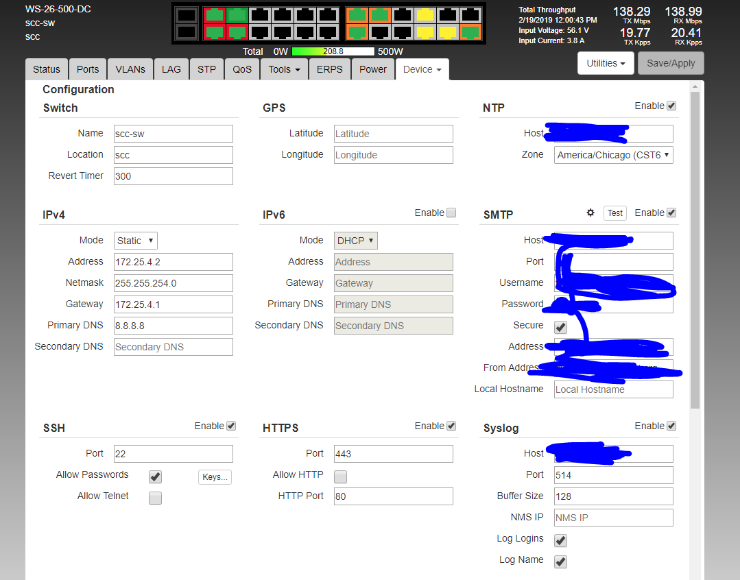

Please disable Discovery Protocols Ubiquiti / Cisco / LLDP and the Discovery TAB on the Device/Configuration TAB.
See if that makes a differnce.
If not then if possible disable STP/RSTP and see if that helps.
Also please post up a COMPLETE grab of your Device/Configuration TAB after disabling Discovery.

discovery was all unchecked to start with.
