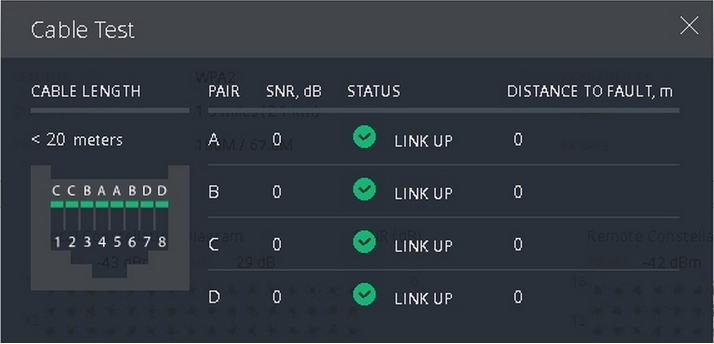

Chris and I just had a phone chat on this, and there could be several things causing this.
I did hold back some information that this is the tower site that took a direct lightening hit :icon_eeeek: over the summer. However, some of the cable runs and radios are new since then, so that's not the issue.
POSSIBLE CAUSES FOR THESE ANOMOLIES:
* We are using EZ-RJ45 ends which have the open copper ends, RF from the test may be escaping the cable end and cross-talking.
* We are using di-electric grease in each Ethernet port which may not be completely RF transparent and causing cross-talk at the end - couple this with the EZ-RJ45 end.
* There may have been a bad batch of cable when we hung some of these radios.
An airFiber on the same tower which is using EZ-RJ45 ends, but is NOT using di-electric grease is coming up OK/OK/OK/OK lending some credibility to the di-electric theory. Additionally, a NanoBridge connected to the switch with no di-electric also comes up OK/OK/Abnormal/Abnormal.... so... di-electric maybe?
I'll be testing this in the office over the next few days when I get a moment.
