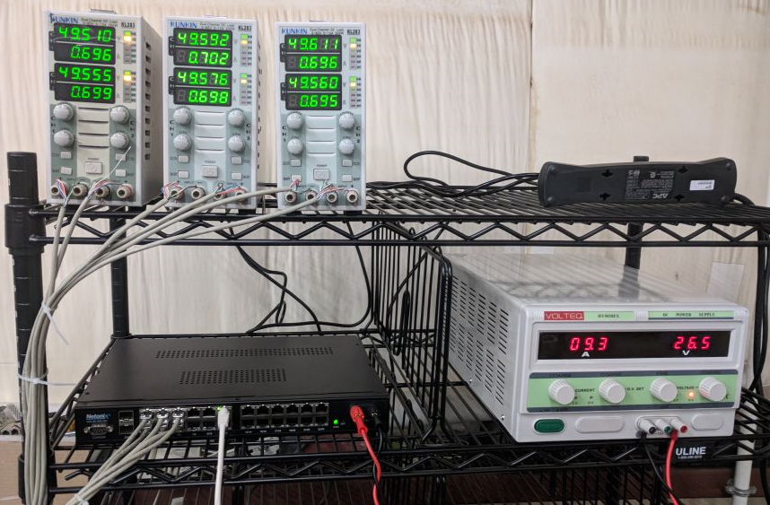

Quick update: am about an hour in on a test with one of ours, everything seems to be running okay. The real indication will be when I swap your unit in, if we get reboots we'll know more about where to look. Definitely need that unit here, though, so if you haven't already, submit an RMA so we can really get rolling.
Below test at this moment:
Model WS-26-500-DC
Firmware v1.4.9
Input voltage 26 +/- volts
Load: 250+/- watts
- Ports 1-6 using 48VH 35 +/- watts each port
Model WS-26-500-DC
Firmware v1.4.9
Load: 250+/- watts
