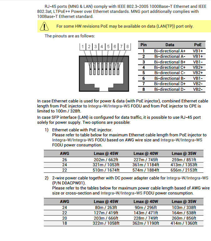

Anyone powering SAF Integra units? We just got in some 18Ghz 2+0 config, SAF units I need to use Netonix LAG to combine the bandwidth, and hopefully power it. The power supplies they come with are a bit confusing, but I know are 48VDC. Not sure to use 48V or 48VH, but don't want to burn out the radio or anything.

Thanks for quick reply Chris. I dug in and found the pin-out in the manua (see attach), looks like it uses all 4-pair for power

So from your picture it shows their polarity PIN out is:
PINS 1,2,4,5 as positive
PINS 3,6,7,8 as negative
Now compare that with our polarity pin out located in the following places:
Our PDF:
The product descriptions on our web site located under the picture of each model switch:
24V POE Option: Pins 4,5 (+) Pins 7,8 (-)
48V POE Option: Pins 4,5 (+) Pins 7,8 (-)
24VH POE Option: Pins 1,2,4,5 (+) Pins 3,6,7,8 (-)
48VH POE Option: Pins 1,2,4,5 (+) Pins 3,6,7,8 (-)
So we show our polarity PIN out as:
They show their polarity PIN out as:
Looks like a match to me to use 48VH POE option?
Our PDF:
The product descriptions on our web site located under the picture of each model switch:24V POE Option: Pins 4,5 (+) Pins 7,8 (-)

UPDATE: Successfully powering my Integra WS with one on the desk, pulling a whomping 30W of power, but it is working!
