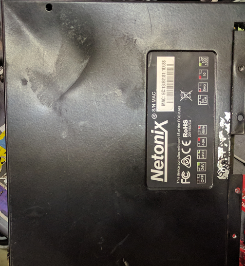

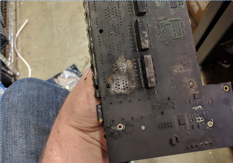

So, here's what I can't fix:
We got this switch in with a few others, apparently there was a lightning strike on an ungrounded building -- Take that, all you guys that say grounding doesn't make a difference.
If you think that's bad, try the bottom of the board:
All of the board interconnects were welded together, so I had to do a fair bit to even get the board out.. not as much as they had to do to get the switch out of the rack, though, from the looks of this:
When it's this bad, RMA is probably not your best option. Thought you guys might enjoy a dose of electronics gore.
