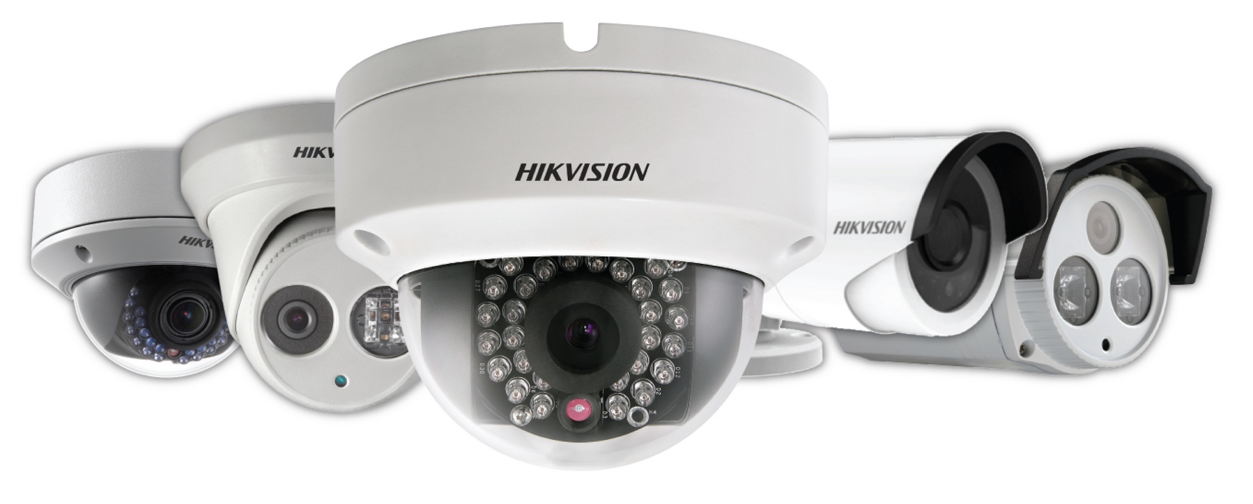

HIKVision cameras work well with these switches. The outdoor PTZ cameras that require a "POE ++" injector work perfect with the 48VH poe output, and poe+ cameras all work well with 48V.
