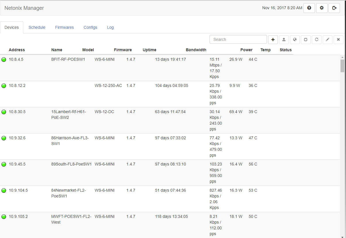

I'm curious about the formatting of columns and column headers in the default "Devices" display. The image below shows how it appears on my screen (Google Chrome browser on a Windows 10 system). Using Firefox on the same Windows 10 box, it appears the same.
It sure would be nice to be able to widen the "Bandwidth" column.
And of course there could be better alignment of the column headings with the column data...
Dave - Employee
- Posts: 730
- Been thanked: 159 times
thanks, I have asked Eric to look at this for you, and yes, we need to clean this ap up somewhat....it's on our list....
