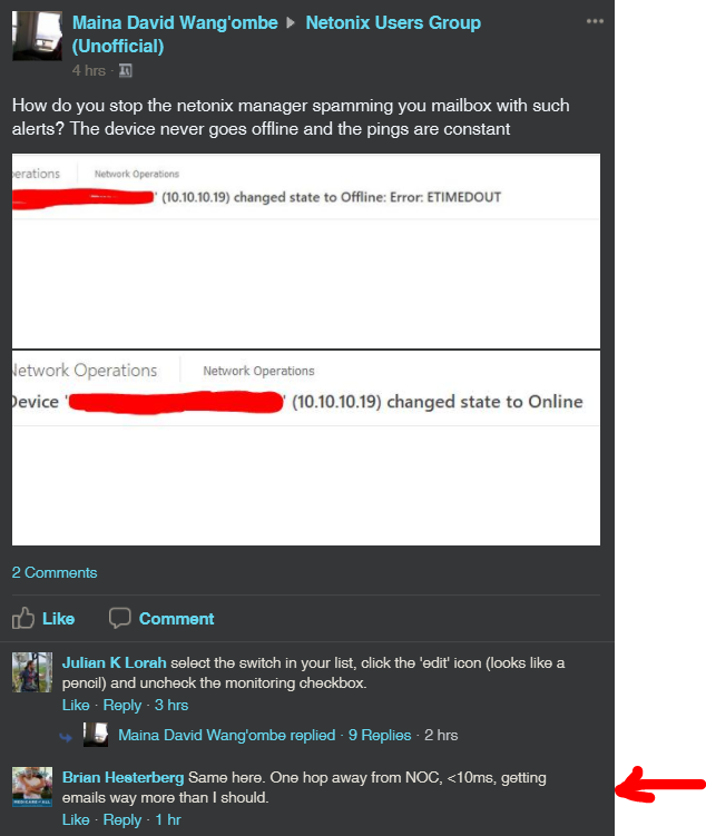

Hi Guys,
I have the netonix manager spamming my alerts mailbox with so many of this errors(have 40 or so switches on the network). Pings constant and switches never really go down. I have switches several radio hops away with double digit ms. Had stopped using the manager and only started managing the switches again with the most recent release(1.0.6) but this is still an issue since last year on my network.

You'll need to figure out why the connection to your switches is timing out. No one else has reported this problem, it has to be something specific to your network.
Hi Eric,
It could be an issue in my network, but its happening to atleast half of my switches regardless of ping response times. There has also been at least one other person reporting the same on their network. His switch is 1 hop from the core with < 10ms.

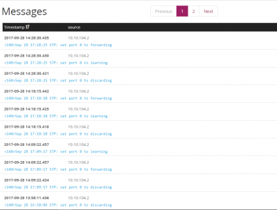

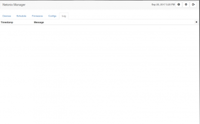

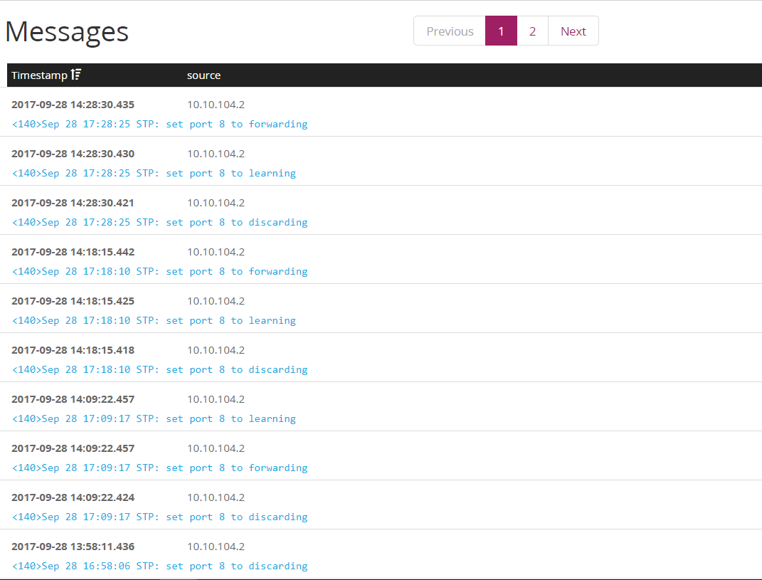

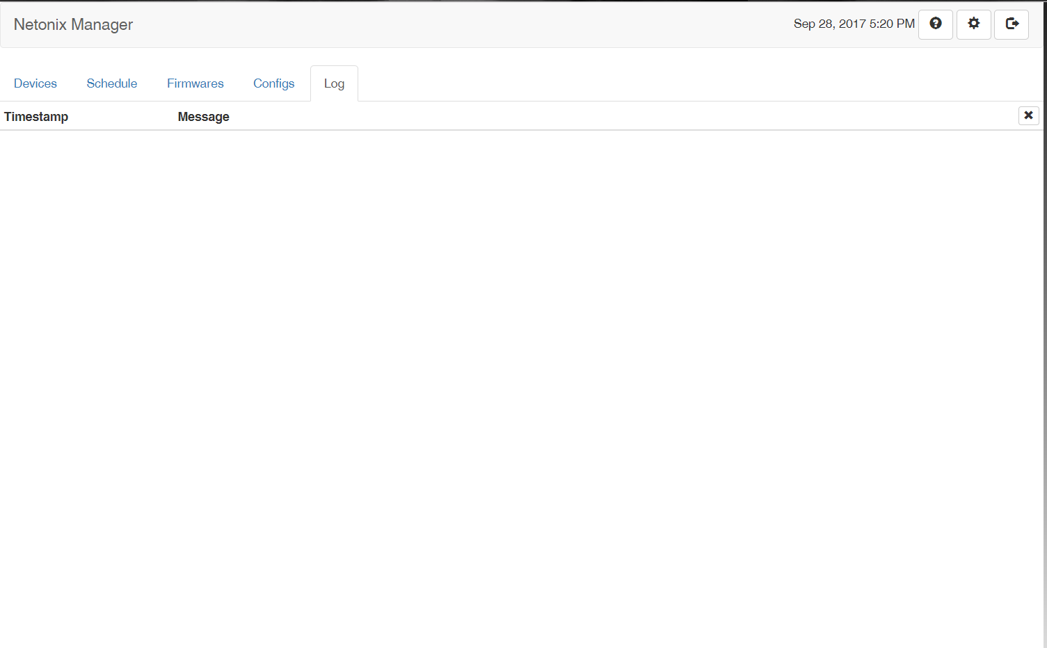

Hi Eric,
I still face the issue of too many ''NX_WS8_DC' (10.10.107.102) changed state to Offline: Error: ETIMEDOUT'' reported by the netonix manager. I also cant see any logs on the logs tab but when I click on the yellow button, it shows what alerts are available. Like a failed tftp backup.
Above are screenshots of my graylog server receiving switch alerts but nothing showing on the netonix manager. The ETIMEOUT issue is occurring all over my network but my NMS never reports any downtime.
Dave.
Eric Stern - Employee
- Posts: 532
- Location: Toronto, Ontario
- Been thanked: 130 times
The Log tab is for viewing the Manager log , not the switch log. To view a switch log you need to need to go to that switch's web interface.
I don't know why you are getting timeouts. Doing some captures with wireshark might help you figure out what is going wrong.
