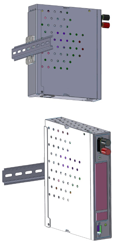

I'll second mounting options. DIN mounting vertical with ports out is critical.

Re: DC Switches
We actually designed a custom universal DIN rail mount that we'll be using with our Netonix switch as well as our routers, tycon battery controller, etc. - just waiting on fabrication to complete the initial run. The majority of our sites are mountain/rural with DC power and a small NEMA enclosure so the ability to stack routers/switches/etc. with DIN rails is helpful - even when the device isn't designed for them.

Re: DC Switches
That was my first thought when I looked at them. "Now how can I make this look NICE in the outdoor box", I see you can mount them flat, with the provided (2) wood screws (thanks Chris), but I would like mine to stick out straight (takes up less room on the back board, plus you can see the ports easier when they are facing you).

Re: DC Switches
wispwest wrote:That was my first thought when I looked at them. "Now how can I make this look NICE in the outdoor box", I see you can mount them flat, with the provided (2) wood screws (thanks Chris), but I would like mine to stick out straight (takes up less room on the back board, plus you can see the ports easier when they are facing you).
I also, have yet to install mine. I do plan any day now, just a lot of 'unexpected' things have come up that I had to deal with. Plug I'm trying to find wire and crimp lugs that will fit my Tycon 48VDC power controller. I just want to do this right, as well as a nice and clean, professional install. The whole reason I waited for the DC versions instead of cracking open and 'jerry-rigging' wires to the board bypassing the AC transformer.
I can't wait to put these in though. I plan for ever one of my 40 tower sites!
We are soon releasing a DIN mount for all the MINI switches:
WS-6-MINI
WS-8-250-AC
WS-8-250-DC
WS-12-DC
WS-12-250-AC
WS-12-250-DC
