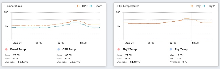

Since this topic is about temp and fan cooling here is my daily temp graphs from my Netonix that its placed in a sealed IP65 metal box.
Since during midday hours fan speed is constant above 9300RPM is there any issue with MTF of the fan? Should i open breath holes so the air to circulate (chimney effect)?

Posts: 7604
Has thanked: 1674 times
Been thanked: 1358 times
Re: fan speed
Mon Aug 24, 2015 4:47 pm
Your board temps look OK.
Air flow can not hurt but the switch is not in any distress according to your telemetry.
