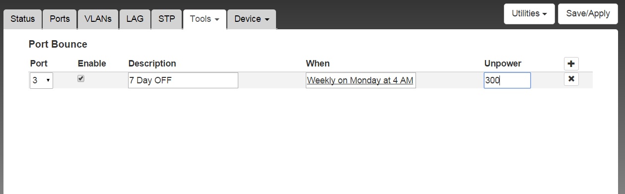

How much of a cost would it be to have the another feature like Port Bounce but have it set on a timer that will auto kill the poe every 7,14,21,28 days? and keep the power off for 5 mins? For my use this would be a great improvement to your already great switch
Re: WS-12-250-DC added feature
You can do that now?
This would turn off Port 3 every 7 days for 5 minutes
wow me so darn busy i missed that thanks for this.
