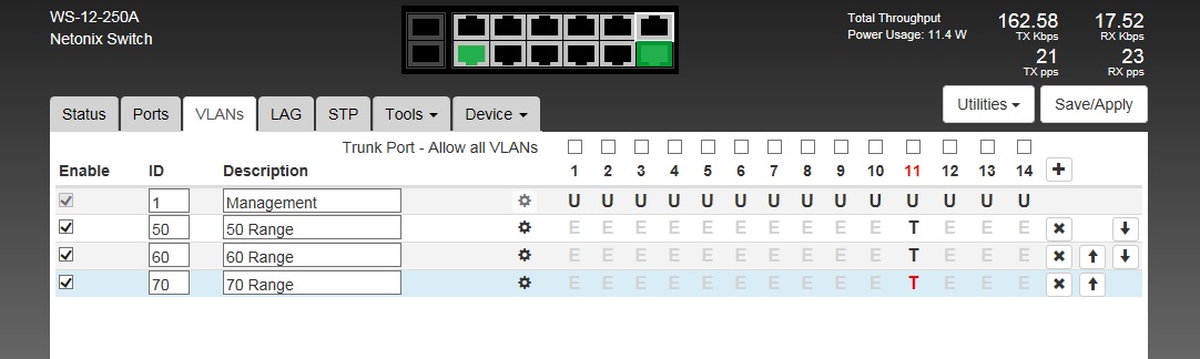

Eric Stern wrote:Can you post a screenshot of your VLAN tab?
Clicking on the T will not change it to an E, in fact nothing happens, except it does go red.

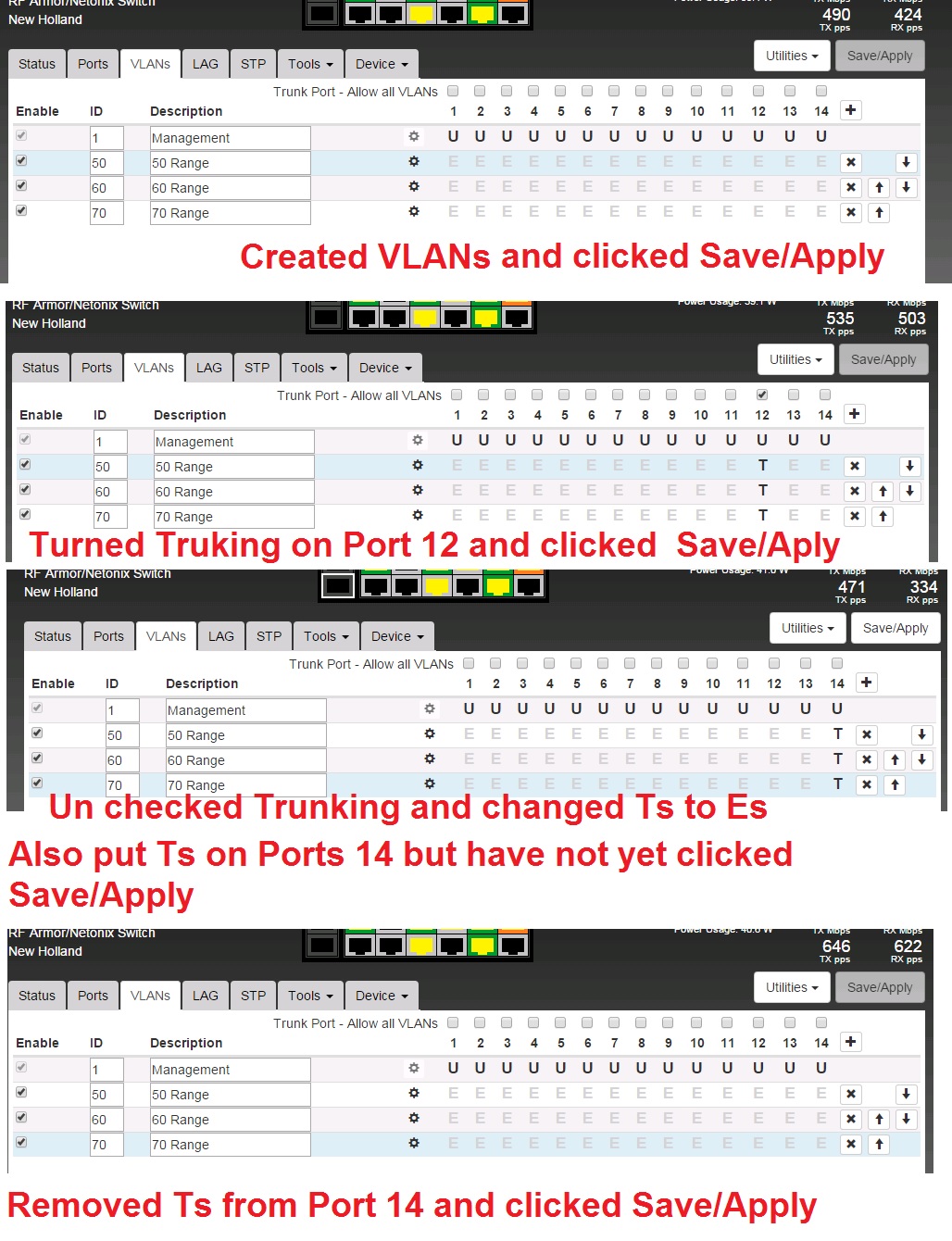

Well I don't see any problems here, it should work, and no one else seems to be having this problem.
I guess I would suggest clearing the browser cache, and then trying a different browser and see if that helps.
Re: Cannot exclude port after a trunk has been selected.
Thu Jul 23, 2015 10:13 am
I logged into the WS-12-250-AC at the warehouse running v.1.2.4
Below is what I did, worked perfectly.
VLAN Trunking Experiment.jpg (413.07 KiB) Viewed 9388 times
