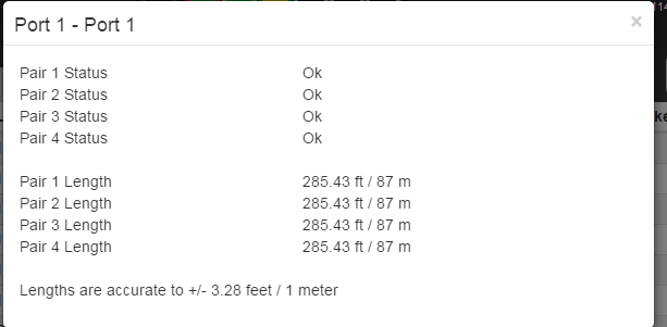

Here is 1 of my diagnostics of 1 of around 20 AF links on my Towers:

Here is one of my AF port details

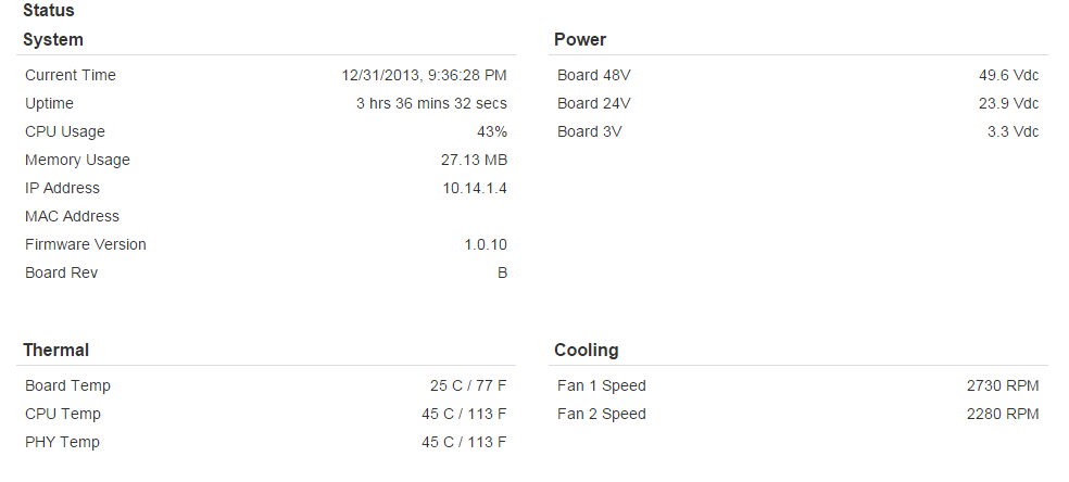

I ended up using another switch I had laying around as I had to rework some wiring etc.
I have the port layout the same as before, but an entirely new switch. 3.5hr uptime and about 328 errors already.

ctak99 wrote:I ended up using another switch I had laying around as I had to rework some wiring etc.
Not sure what you're saying?
The new switch is our switch or another manufacturer?
I thought we left it that you were going to swap port 1 with port 2 and see if the errors followed the radio/cabling?
Anyway PLEASE upgrade that firmware - v1.0.10 is OLD firmware - use version 1.1.3

Re: Port Errors
Tue Mar 24, 2015 6:55 pm
From the pics, it looks like he installed another WS-12-250B and still got errors.
Looks like it is time to replace the cable / connectors.

wayneorack wrote:From the pics, it looks like he installed another WS-12-250B and still got errors.
I would agree, I was hoping he swapped port 1 with port 2 and the errors followed the link/cable which would point a very definite finger.
But too many people use these switches to power airFIBER with no problems (including me) so it has to be the cabling you would think as there are over 1,000 WISP Switches out there.
I have fielded about 6 calls on errors powering 1G devices like airFIBER and every single one resolved itself with a new cable run.
Currently I have 2 open instances of this including this one, did not hear back from the other guy today so maybe it is closed?

I had to re organize the rack and moved the UPS around so I had another WISP switch (yea old firmware) I threw in.
I redid the config the same, but errors continue on brand new switch. So, it is not the switch itself.
